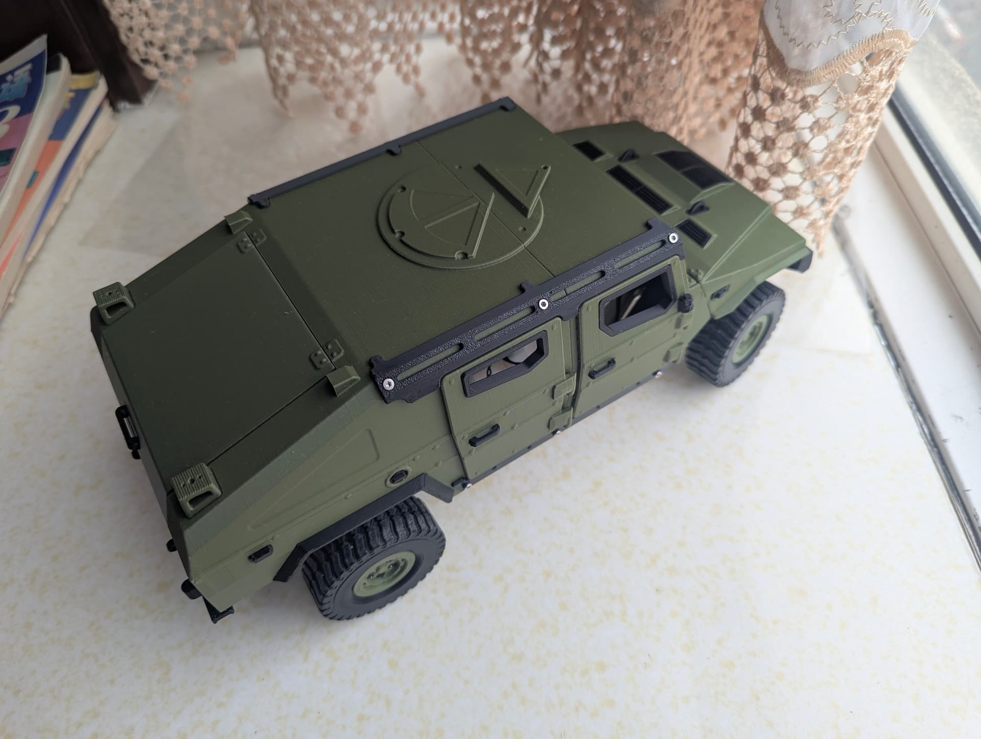

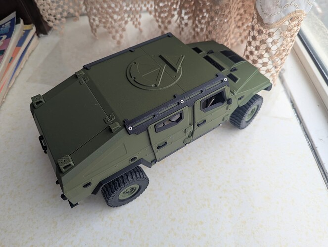

Here’s an interesting fact: I never print PLA with the door open on my P1S, and I’ve never had any issues.
The model shown below was printed during the summer, and I live in a warm temperate region with four distinct seasons.
