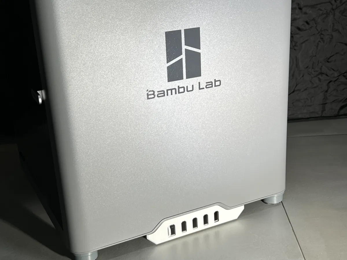

I made this…
I’m not sure if the aux fan is able to pull air through a filter, but a bucket for carbon granules should be possible. I’ll upload the model with an “Action Bucket” in a while.
Check this out :slight_smile:
Nice! Love the little clips. Now, can you get a filter in there??? The P2S filter maybe?
It is possible, but I would need to raise the P2S about 50-70mm off the ground!
OMG! U Made it =D Well done!

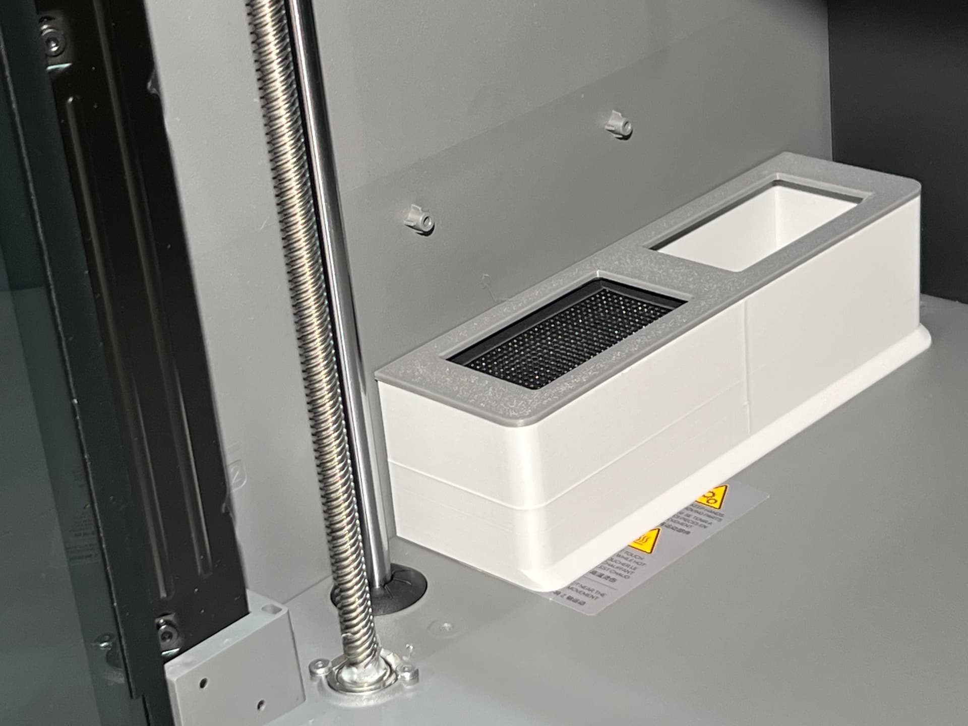

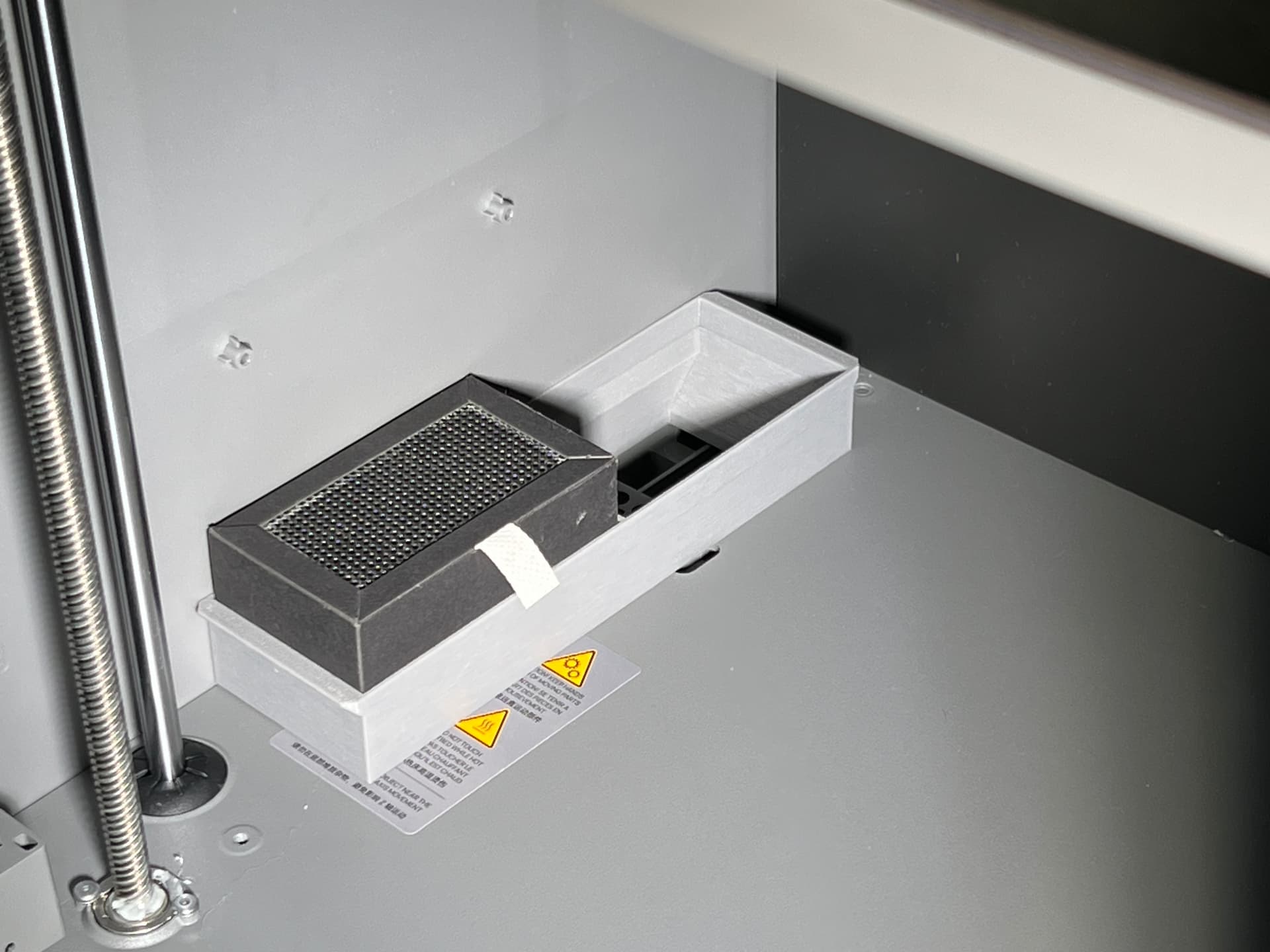

Finalising the design for the filter “action buckets”.
Good work! :heart_eyes: 25charrrrrrr
Looks like a few of us are working on the problem. I’ve completed my action bucket for the Carbon filter as well.
Nice, you’ve made a solution that requires no extra electronics! You just need to increase the surface area of the duct underneath to turn it into a better heat exchanger so the air cools a little as it goes through :smiley:
There’s a model on maker world that’s called " HEPA & carbon filter for Bambu Lab X1C, P1S" so I might try using that if it’s compatible.

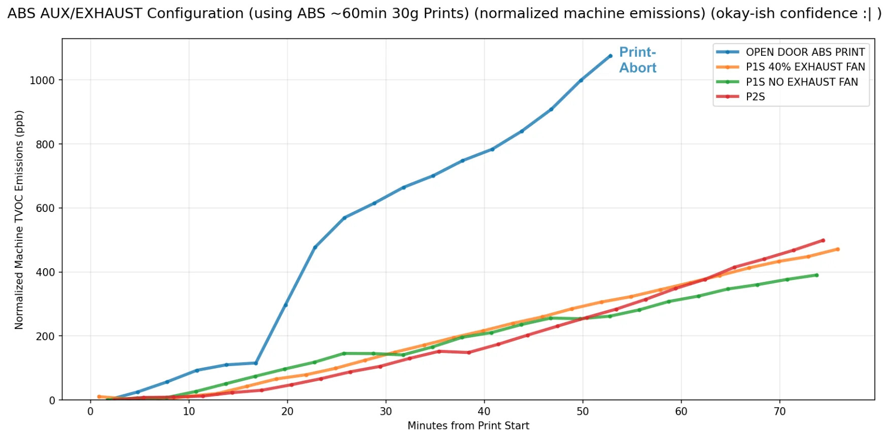

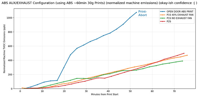

ABS:

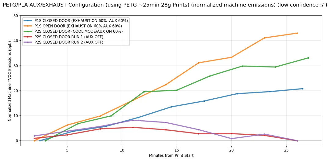

PETG/PLA in Cooling Mode:

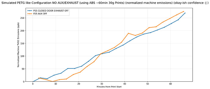

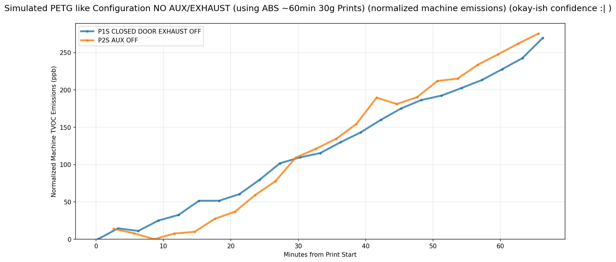

And a condition that was just what the filament profiles were set for PETG (but printed in ABS to get more VOC, since PETG/PLA produces so little). This kind of just tests the general air-tightness of the case.

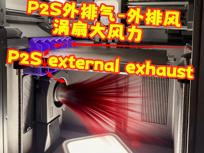

Alternatively, to prevent VOC build-up in the first place, create a slight negative pressure and push the air out of the window:
and put the hose out of the window.

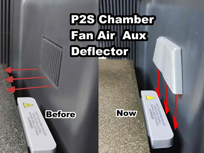

Oh, and this one will probably even get more useful now that PETG will also use the internal filter mode, I made this mod to blow the air down during ABS prints:
I hope the results are at least somewhat helpful :sweat_smile:. Treat them with caution, though. The ABS tests were fairly easy to do since the sensors picked it up easily, but the PETG ones were much harder because of the lower levels emitted and more airflow around the printers. At some point, I just reduced the print times because I was getting tired of repeating the tests so many times while testing out different sensor positions. :frowning:
Great write-up! I wonder if the little bump in PETG emissions was from the poop that was ejected out.

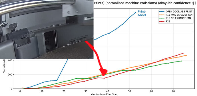

I’m surprised by the first graph that the P2S line is on par with the P1S line even though it has a built-in recirculating filter.
This is now purely speculation on my part, but I think that’s just the case of leaking air out due to heat convection + at least some of the air being blown into the wall and then exiting through the not airtight gaps.
I can’t explain it in any other way, I mean this heat-convection thing can be also seen with the no-fan condition it doesn’t smoothly exit the printer it always leaves in “puffs” or steps. When printing with PETG which prints at lower heatbed temperatures and chamber temperatures, the no-fan condition produces extremely low levels that are close to just me sitting in the room.
With the middle step on the P2S, it happens exactly when the build-plate reaches the carbon-filter, before that the carbon filter is below the build-plate:
At least that is what fuels my current assumption of heat-convection + air being pushed to the case and then escape through some gaps.

Edit: Also, that the P2S performs as well as the P1S, it’s not just the sensor picking it up. Near the end of the 1-hour print, I was able to smell it with both the P1S and the P2S, and the no exhaust fan condition.
During the hole test no poop was pushed out, I made sure filament switching (from the AMS) was done at the beginning while I was still having the window open and exchanging air with the outside. If anything, the poop bumps would have only happened at the beginning.
The test print itself was rather simple, just a tube that covers a big span of the z-height with multiple walls until I hit the time/estimated filament used and no infill, stock 0.4mm nozzles and also flow rate/temperatures set on both printers to the same values. :sweat_smile:
