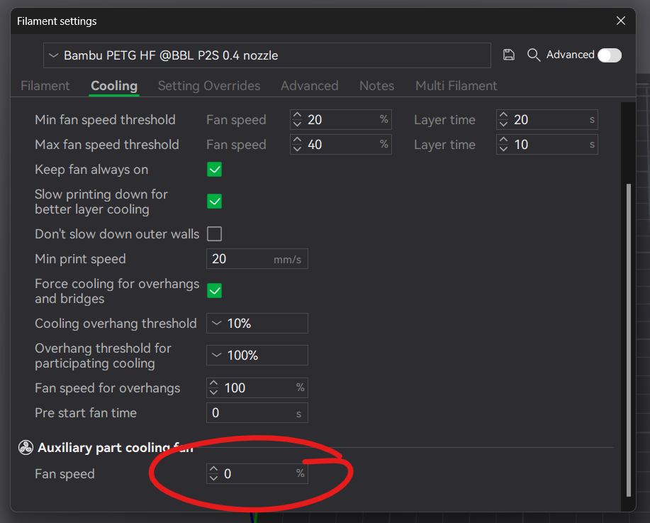

I think to make it do something, you have to enable “Aux fan” in the slicer filament profile. Super confusing.
I changed this to 50% and started a PETG job, now the filter fan is at 50% blowing air out the hole in the middle, not at the aux nozzle.
Time to rerun all the tests? :wink:

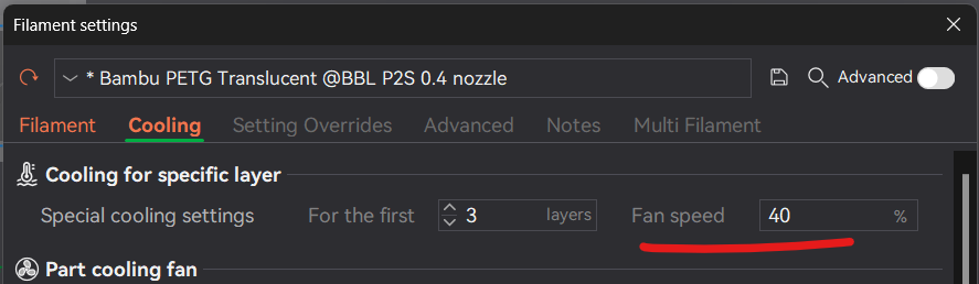

I noticed that the settings are all super inconsistent even during my tests. Even if its set there to 0% it will still enable it at some point after the initial clean and nozzle probing stuff is done :sweat_smile:
Its especially infuriating when you have some PLA models that also warp easily, setting the aux to 0% doesnt give you the guarantee that it will stay at 0%, it sometimes turns on and stays at 40%.
That’s why, for the graphs above, I also checked that all fans are disabled/ or enabled and changed those settings via homeassistant, when the setup/calibration was done and the first line of the model was printed.
And assumed that whatever is configured in the slicer profiles is correct and the intended setting and the reason why they currently wont be properly applied is a bug on my end or with the current version. :sweat_smile:
Also that is one of the reasons why I even did the 0% fan and chamber fan petg test-run, because both PETG profiled have all of them disabled there.

Yeah I think this ALSO controls the Aux fan while disabling the parts cooling fan (or rather, enables the filtering). I think your 40% comes from this.
Super confusing UI. @SupportAssistant I think the cooling tab needs to be updated for the P2S.
