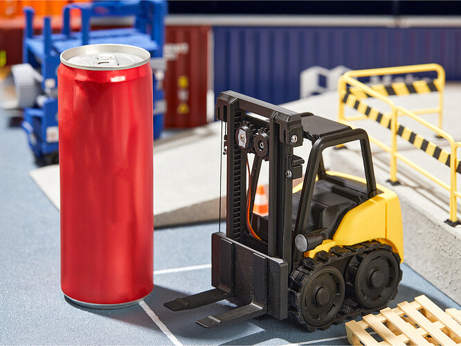

Thanks. Has anyone tried the TPU for AMS? I want to print the tracks for the CyberBrick Forklift.
Should I get the TPU for AMS or TPU 95A HF?
