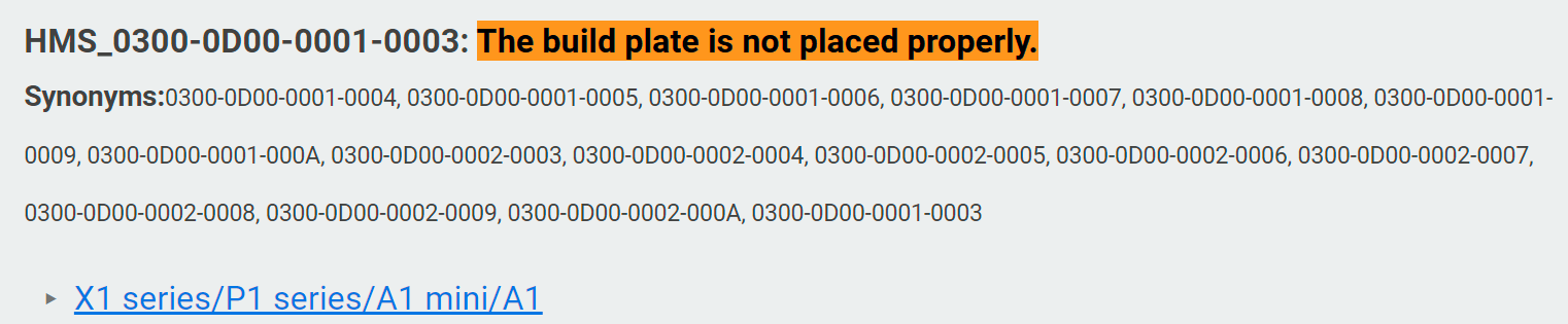

Actually, I ran into something similar and it turned out to be a bed leveling problem due to the bearings popping out. There is a thread on it here as well as a Bambu Wiki.
Did you by chance get any of these error codes on your screen:
Here are two intertwined threads on this topic with possible remedies.
It looks like your bearing has slipped out of place. It should be flush with the bed bracket. Also, you’ve overgreased your printer. This can be the root cause why your bearing slipped. The bearing is held in with a friction press-fit. No friction and… well… I think you can see what happens.

Although I am posting this in the P1 section, this remedy applies to all Bambu Lab X1 and P1 Core XY printers. I cannot speak to the A1, as it is a bedslinger with a completely different Z-axis mechanism. I thought I saw this issue pop up once before but I cannot find that post so I am creating this post in the hopes that it will be easier to find using the exact error messages and code. If someone knows of another post, please post the link here.
