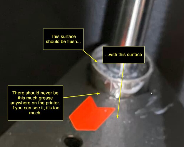

Trouble with bed leveling
It looks like your bearing has slipped out of place. It should be flush with the bed bracket. Also, you’ve overgreased your printer. This can be the root cause why your bearing slipped. The bearing is held in with a friction press-fit. No friction and… well… I think you can see what happens.
