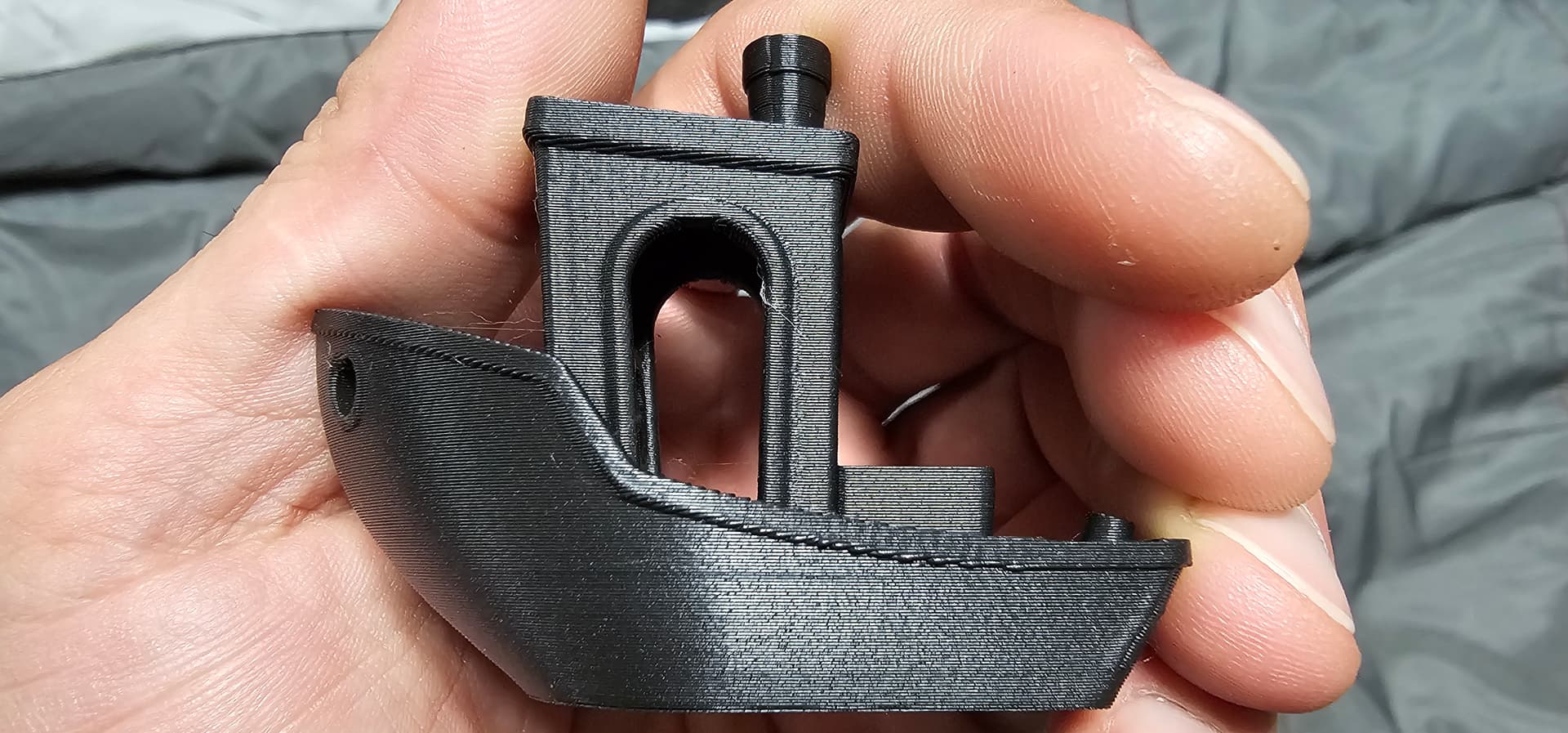

The factory test benchy on my Max3 was something like 18 minutes long, but it consistently came out really well. I used the supplied Qidi PLA though. You probably have to re-slice if you want to use paht-cf.

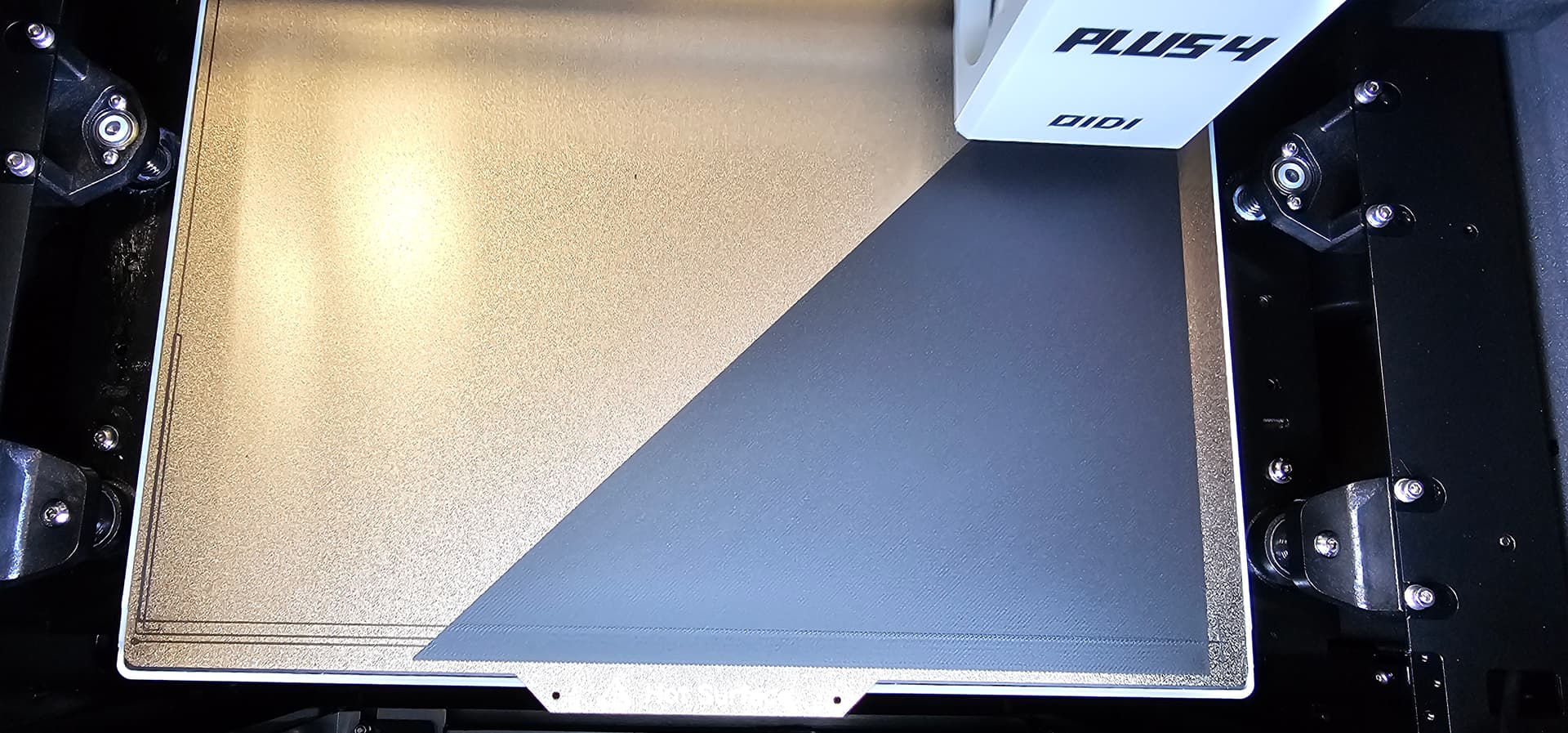

  • Bed plate is the perfect texture and stickiness right out of the box.
  • Bed plate stops are designed well.
  • Probably the flattest bed ive had.

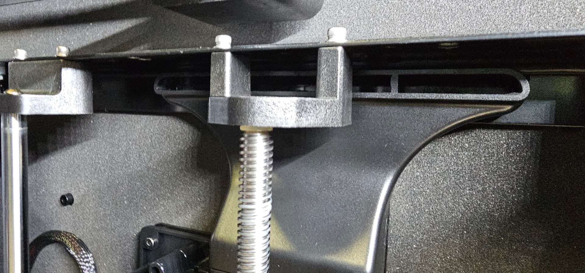

  • They put the aux fan directly behind the screw mount.

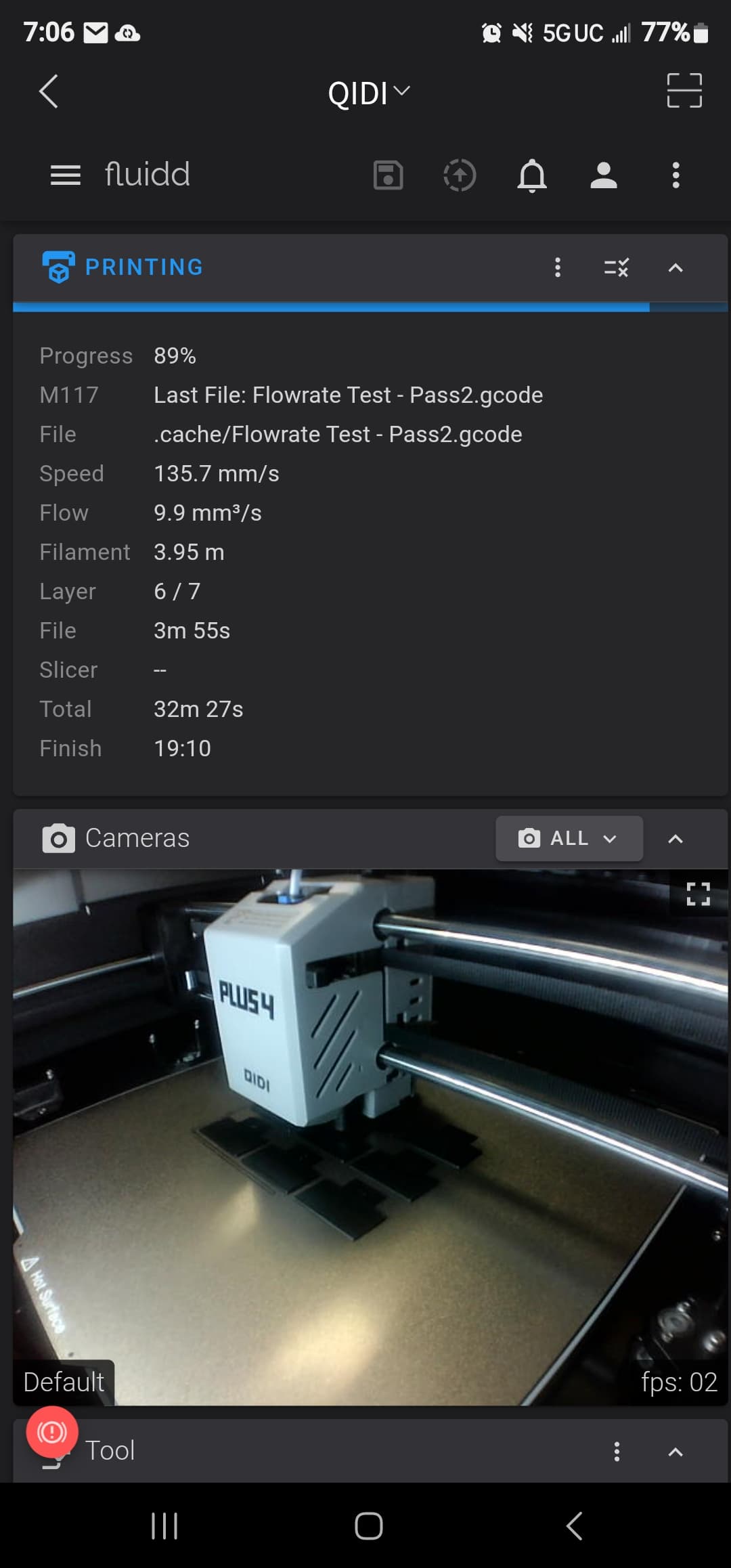

Bambu matte charcoal PLA with no real tuningbyet. Just set flow to .98 and pa to .024
Not seeing VFA

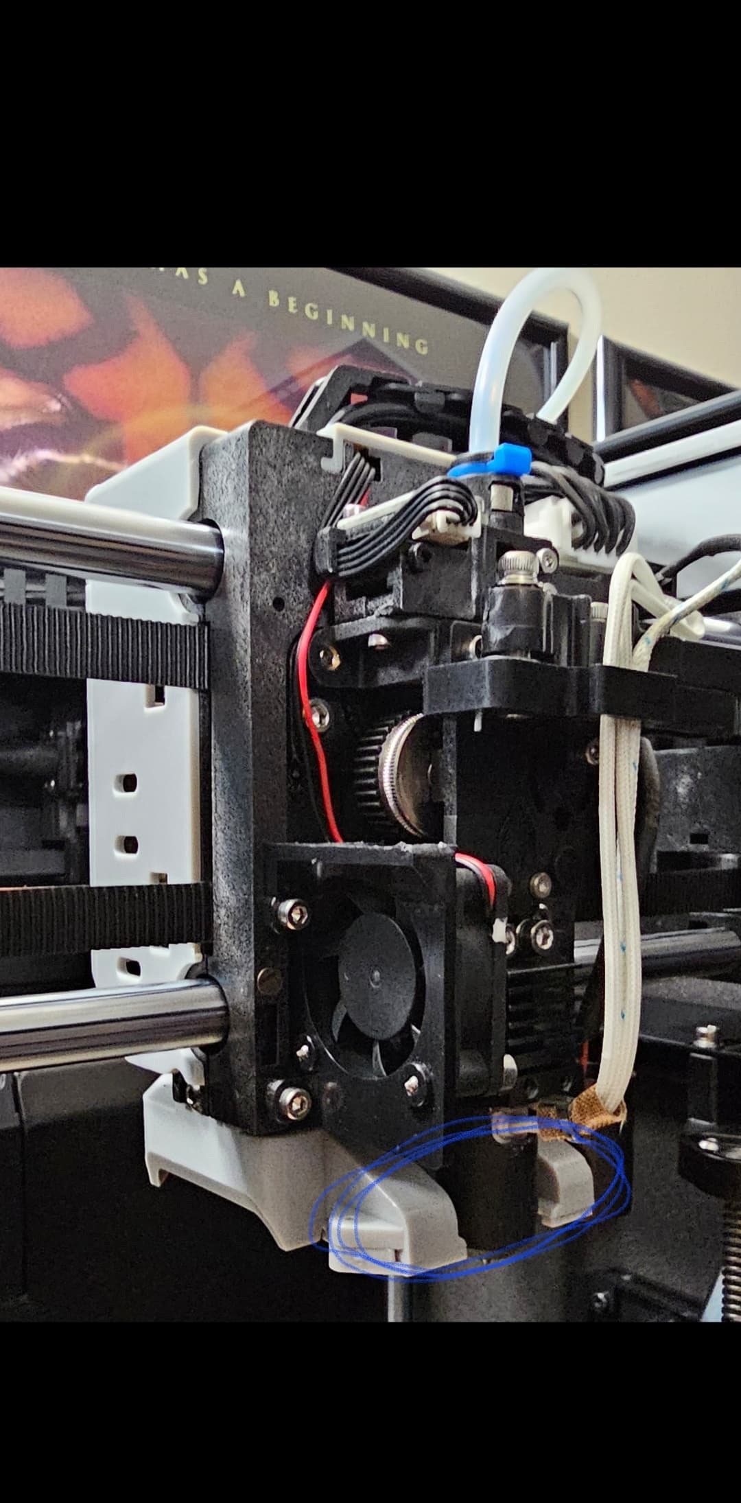

I like that the nozzle is protected from impacts.

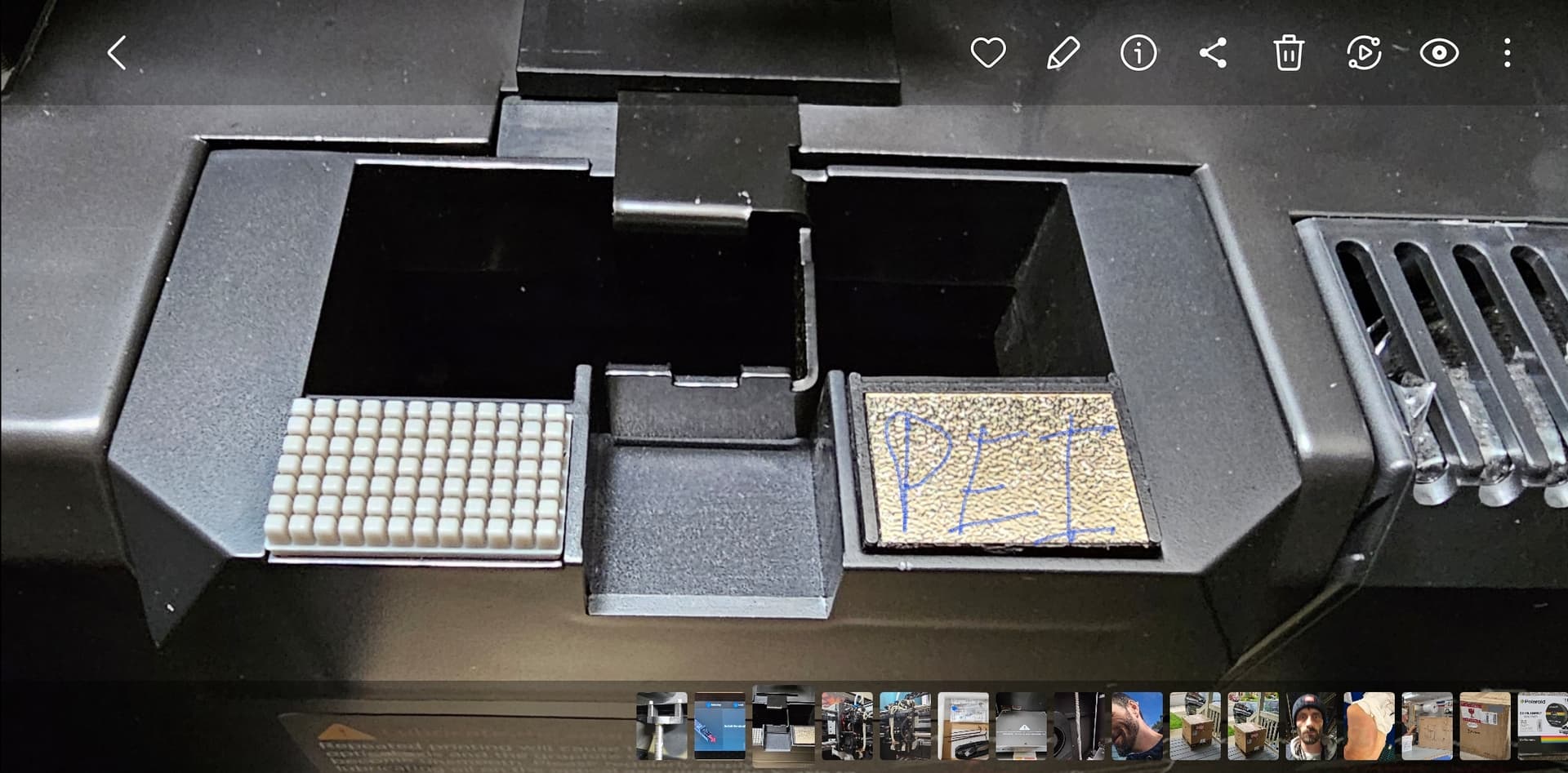

Wiping area with a larger version of the a1 pad to the left and a pei coated section to the right that can wobble as the nozzle moves around it.

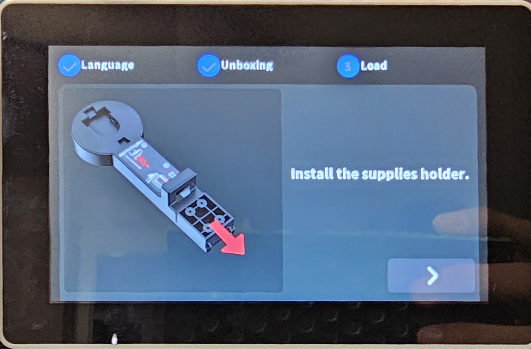

Pretty pictures for the setup right on the interface.

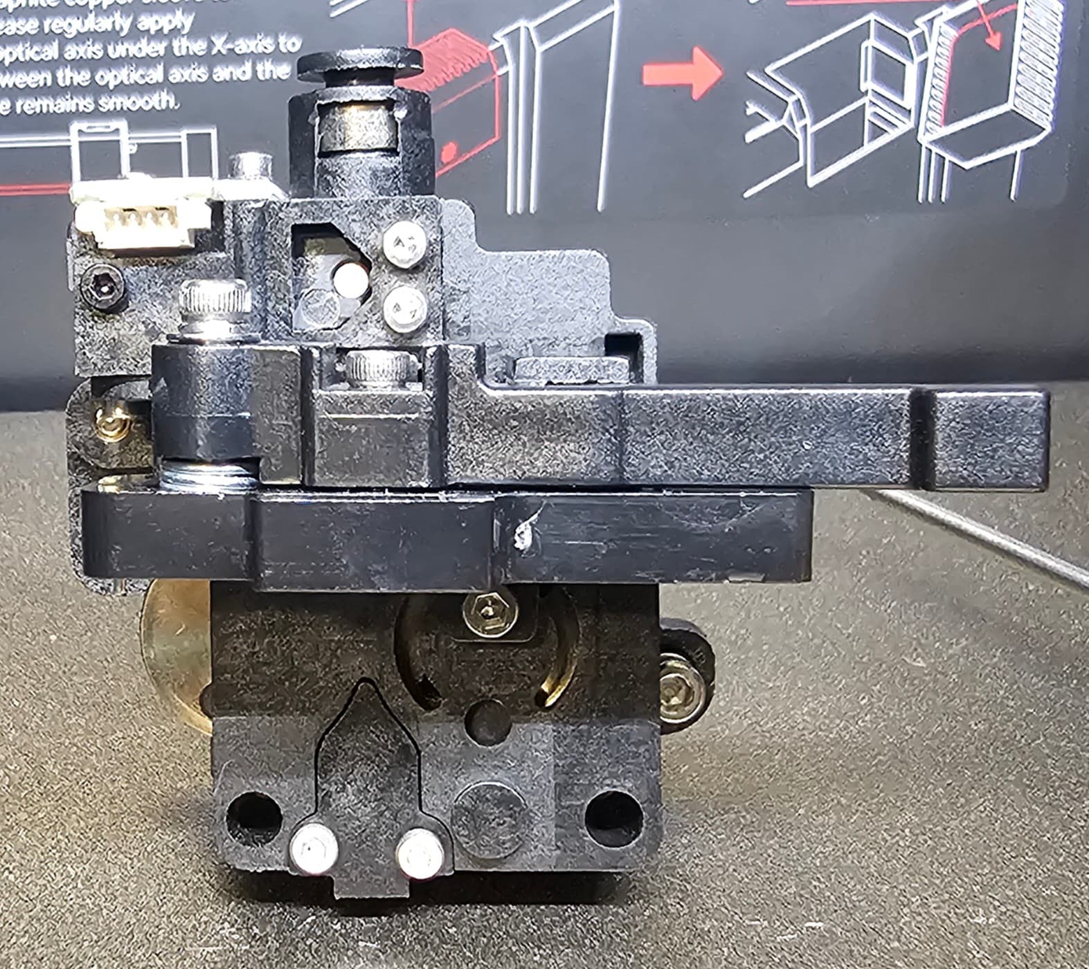

Removable section of the filament path for removing jams.
Pretty prints

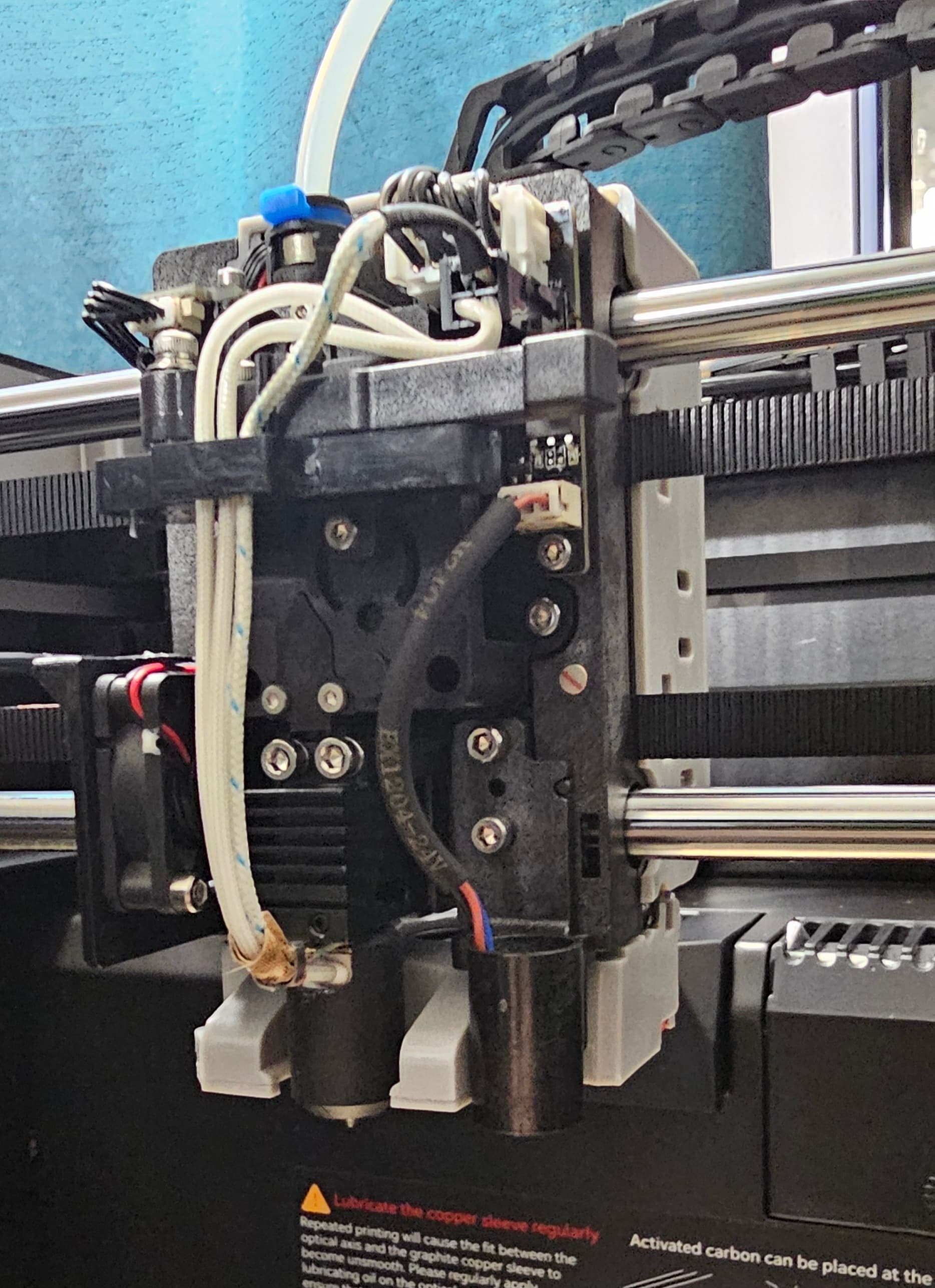

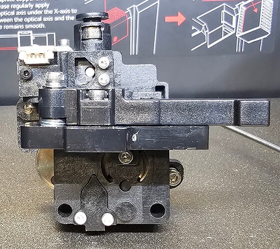

Its 2 screws and a plug to remove the hotend. Another 2 screws and 1 plug to remove the entire extruder.

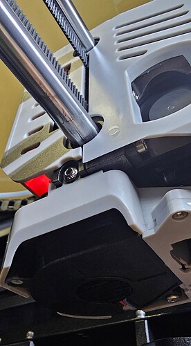

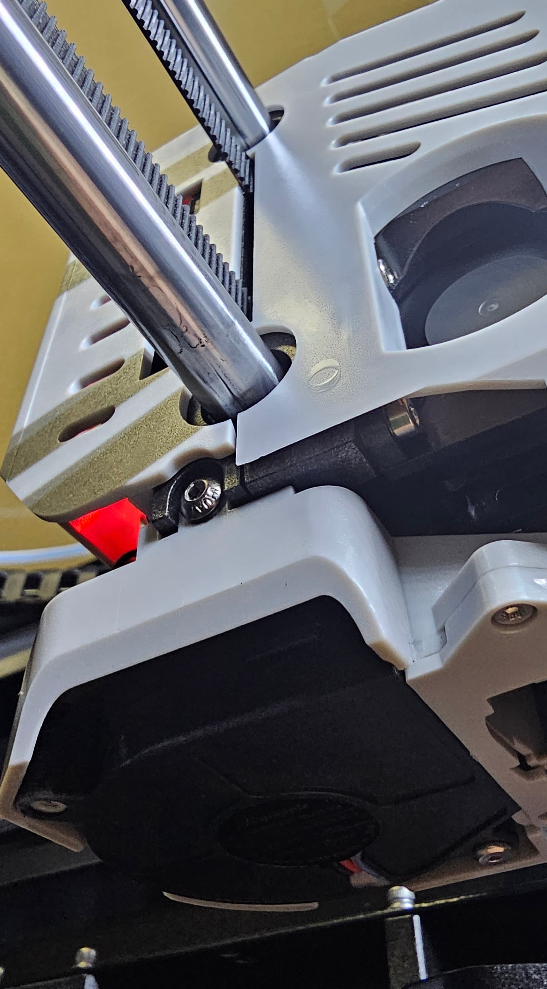

Shot of the part cooling fan below and the hotend fan on the side.

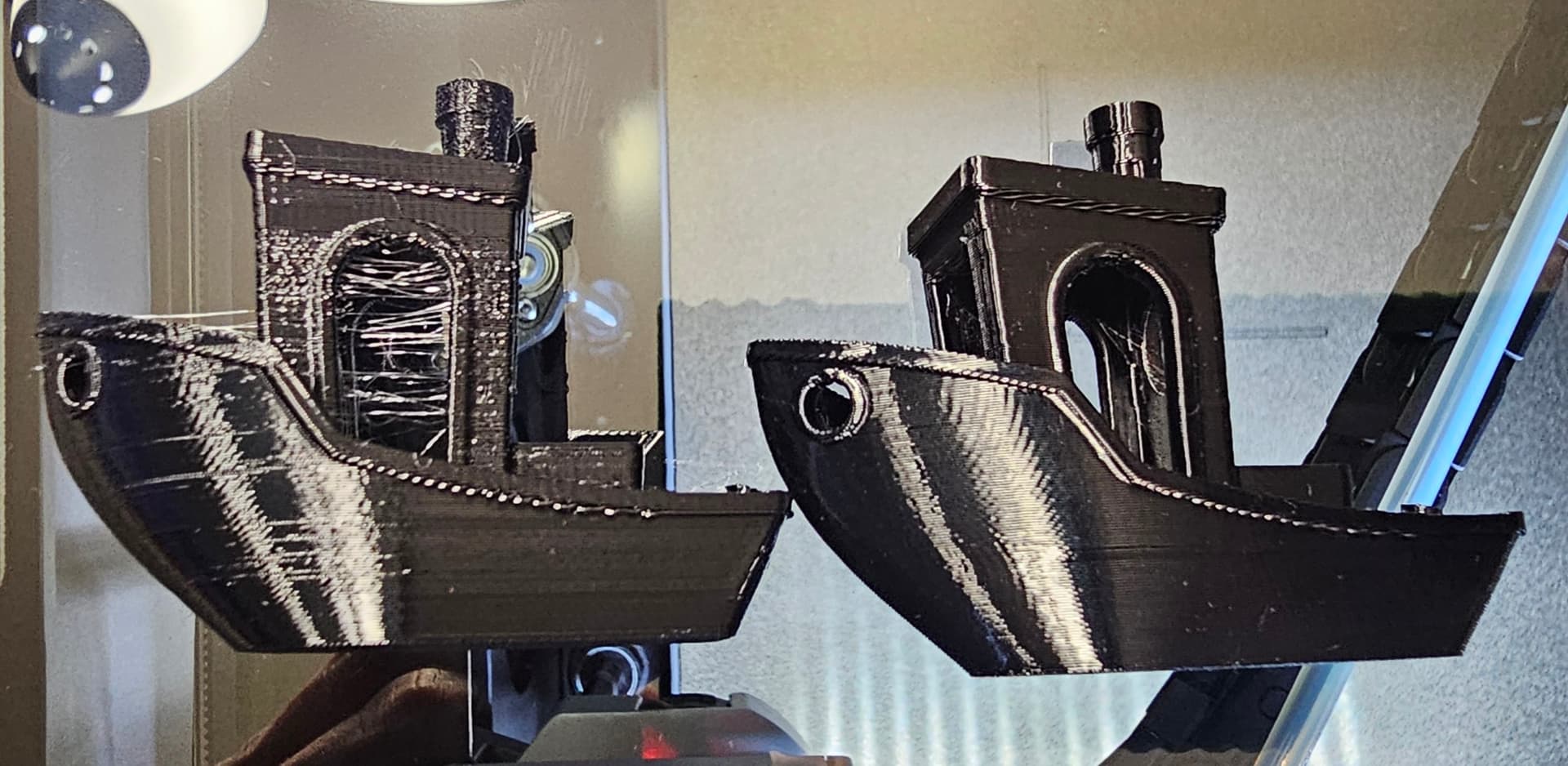

The comparisons below were printed at preset bambu speeds/flows/settings and with the same rolls of filament. All bambu filaments. I wanted to be as fair as possible for the Bambu since we are on a Bambu forum. I printed them fast so that we could see some flaws. I could have made them all perfect.
Qidi plus 4 left, X1c right. .2mm layers in TPU. Im going to redo the left one. I think I had a partial clog from paht-cf

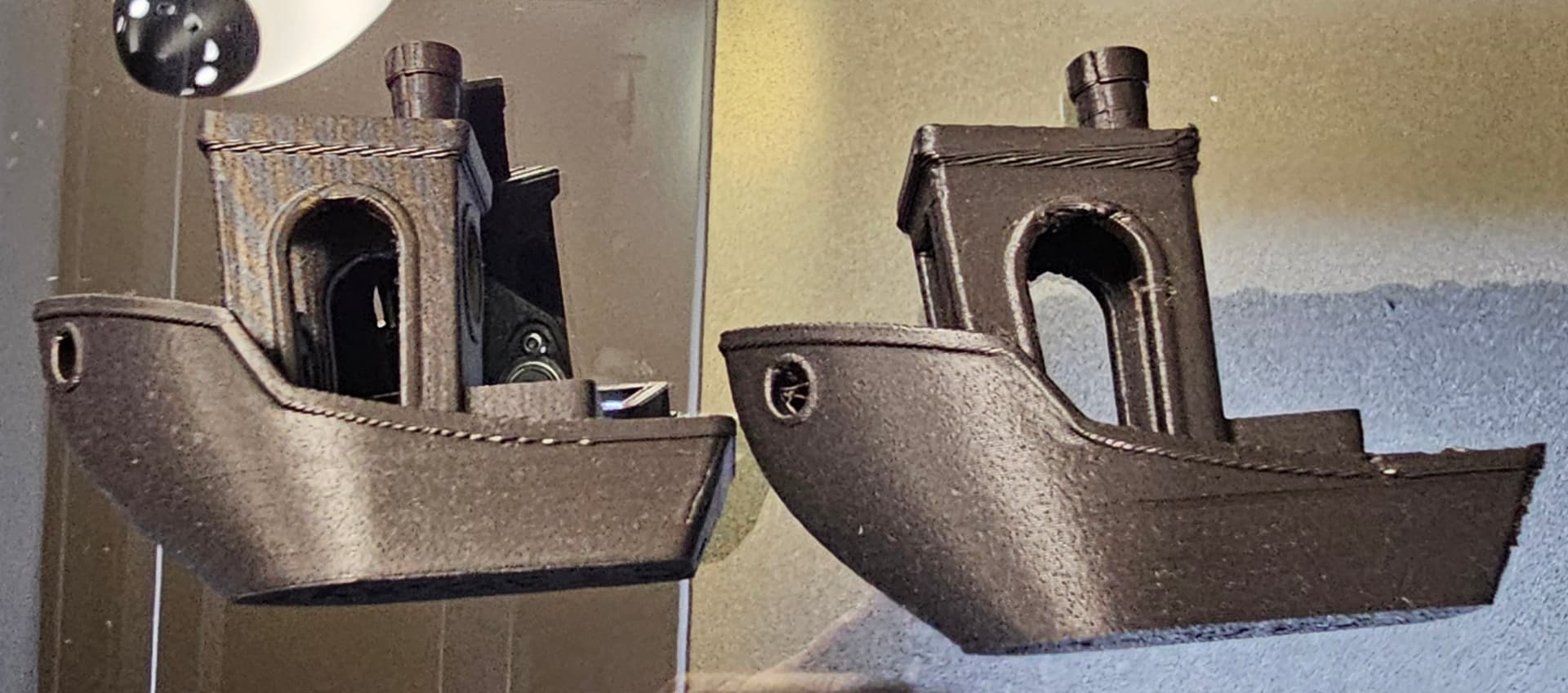

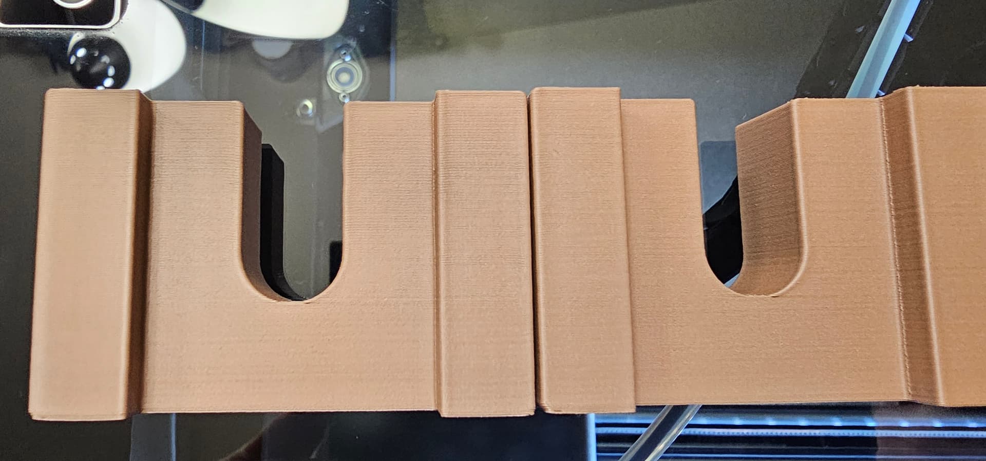

Qidi plus4 on left, x1c on right. .2mm layers in matte PLA.

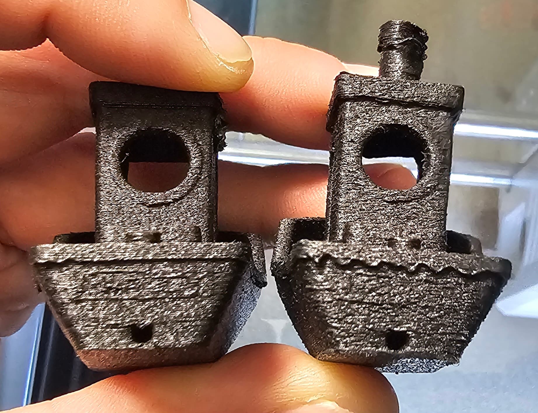

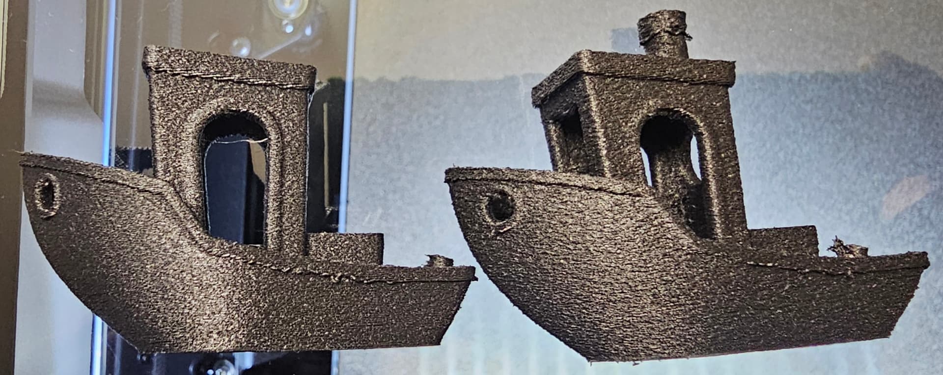

Qidi plus4 on left, X1c on right. .2mm layers in PAHT-CF. The qidi crashed at the end and smashed the smoke stack.(known glitch that i have solved.) and the X1c required a brim to stick.
Same as above photo. Paht-cf

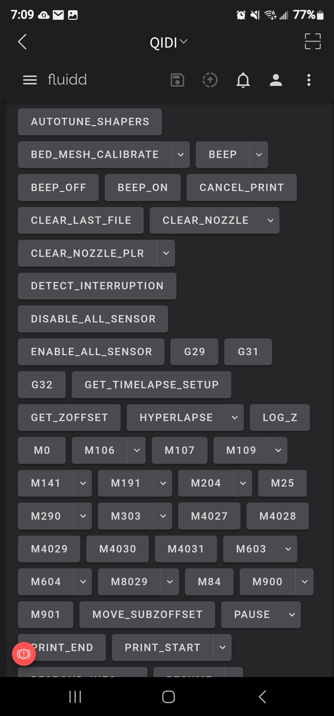

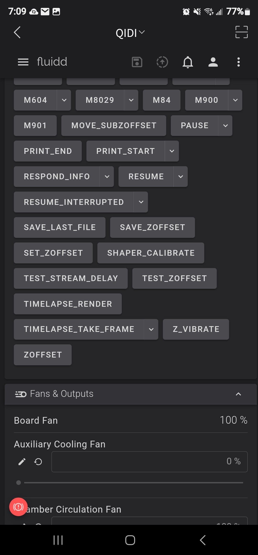

Lots of preloaded macros too, on a side note
