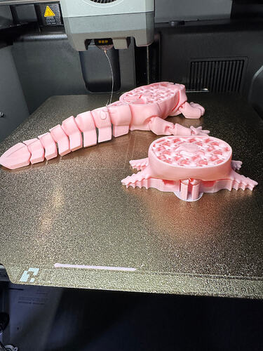

I’m having a persistent issue with my P2S and I’m running out of ideas.
Problem:
The nozzle keeps colliding with already printed material (especially infill and supported areas). As a result, supports get knocked over mid-print and the print fails. This happens very consistently.
Behavior:
  • Nozzle audibly scrapes over infill (Gyroid, Grid, etc.)
  • Supports are physically knocked off, not just weak adhesion
  • Small printed features get ripped away during travel moves
  • Z-hop seems to work during layer changes, but not when moving across printed areas
  • Failure rate is roughly 9 out of 10 prints
What I already tried:
  • Different filaments (PLA, Silk PLA, Metallic PLA)
  • Multiple recalibrations
  • Different support settings (stronger, slower, denser)
  • Different infill types (including Gyroid)
  • General slicer tuning
No meaningful improvement.
Important detail:
This does NOT look like a typical adhesion issue. The supports are not detaching from the bed – they are getting hit and broken off by the nozzle.
Question:
Has anyone seen this specific behavior on a P2S (or similar Bambu printers)?
I’m trying to figure out if this is:
  • a Z-offset / calibration issue
  • a mechanical problem (hotend, gantry, bed leveling)
  • or something related to motion planning / firmware
At this point the printer is not usable for supported prints.
Any concrete ideas or similar experiences would help.

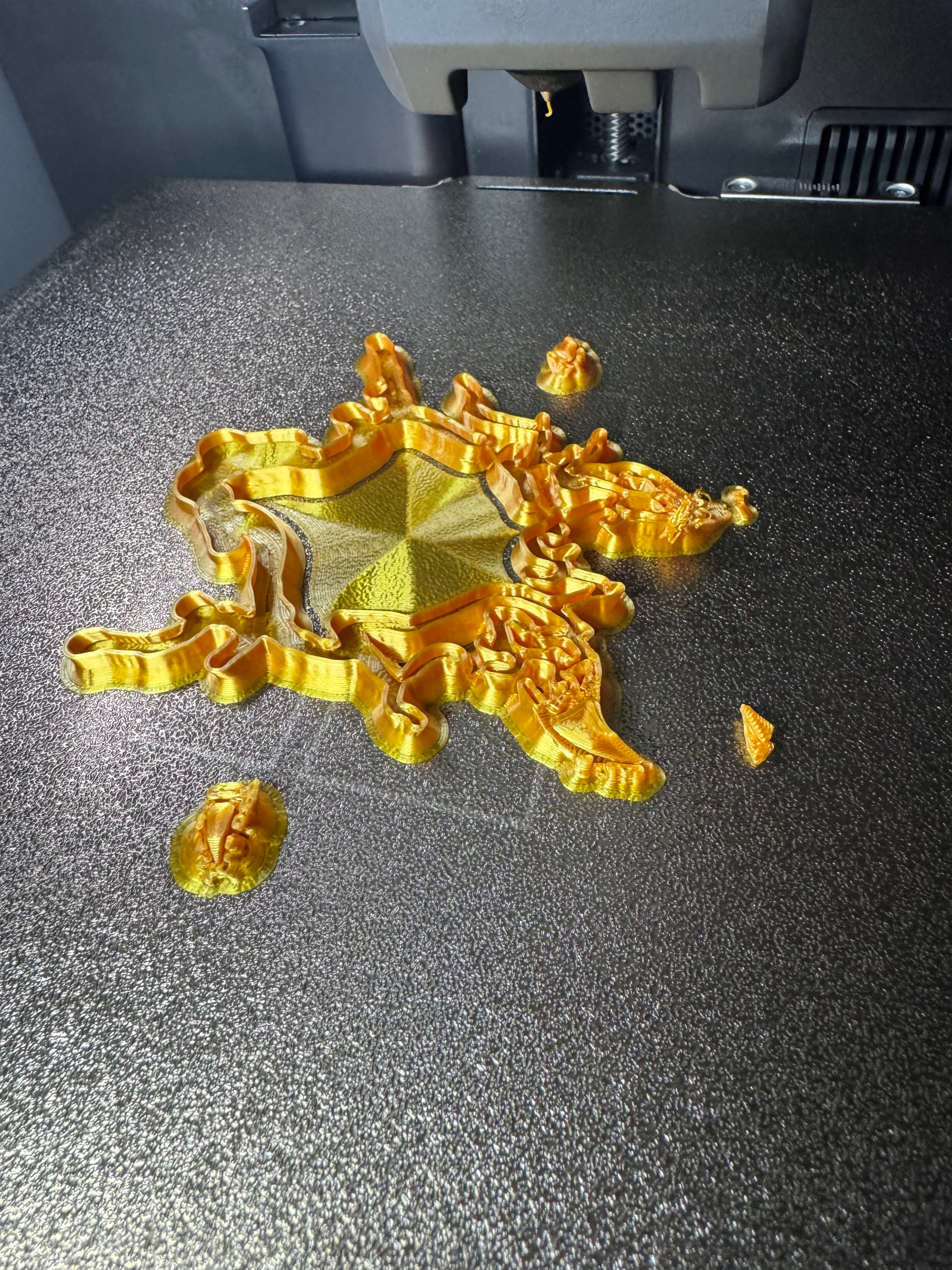

Same problem here on my P2S Combo – and I think I’ve narrowed it down to tree supports.
I watched it happen several times: the toolhead rams a tree support trunk and shoots it to the back of the plate, then the printer keeps printing in mid-air and the print turns into spaghetti. It almost always happens a few millimetres above the top of the model’s base, mostly on trunks that stand on the model itself (miniatures on round bases). Bed adhesion is fine – the models stay firmly on the plate, only the support trunks get knocked over.
To make it reproducible I made a simple test model: Ø50 mm base, centre column, a disc on top and four arms, so it creates tall tree supports both on the base and on the plate.
My results:
  • Bambu system profile “0.08mm High Quality @BBL P2S”, 0.4 nozzle, Generic PLA, “Tree (auto)” supports → a trunk was knocked off at ~layer 67
  • Exactly the same settings, only “Normal (auto)” supports → printed perfectly
Things I already tried with tree supports, all without success:
  • Bambu system profiles, custom profiles, and a MakerWorld model with the creator’s own profile
  • 0.2 and 0.4 mm nozzles, three different PLAs, bed up to 60 °C
  • Z-hop 0.4 / 0.8 mm (Spiral Lift)
  • “Independent support layer height” off, “Reduce infill retraction” off
  • Slower travel (200 mm/s) and support speed (45 mm/s), 2 support walls, thicker branches
  • Full calibration, nozzle removed and reseated, plate cleaned
So for now normal supports are my workaround, but tree supports should obviously work on this printer.
Thanks!
