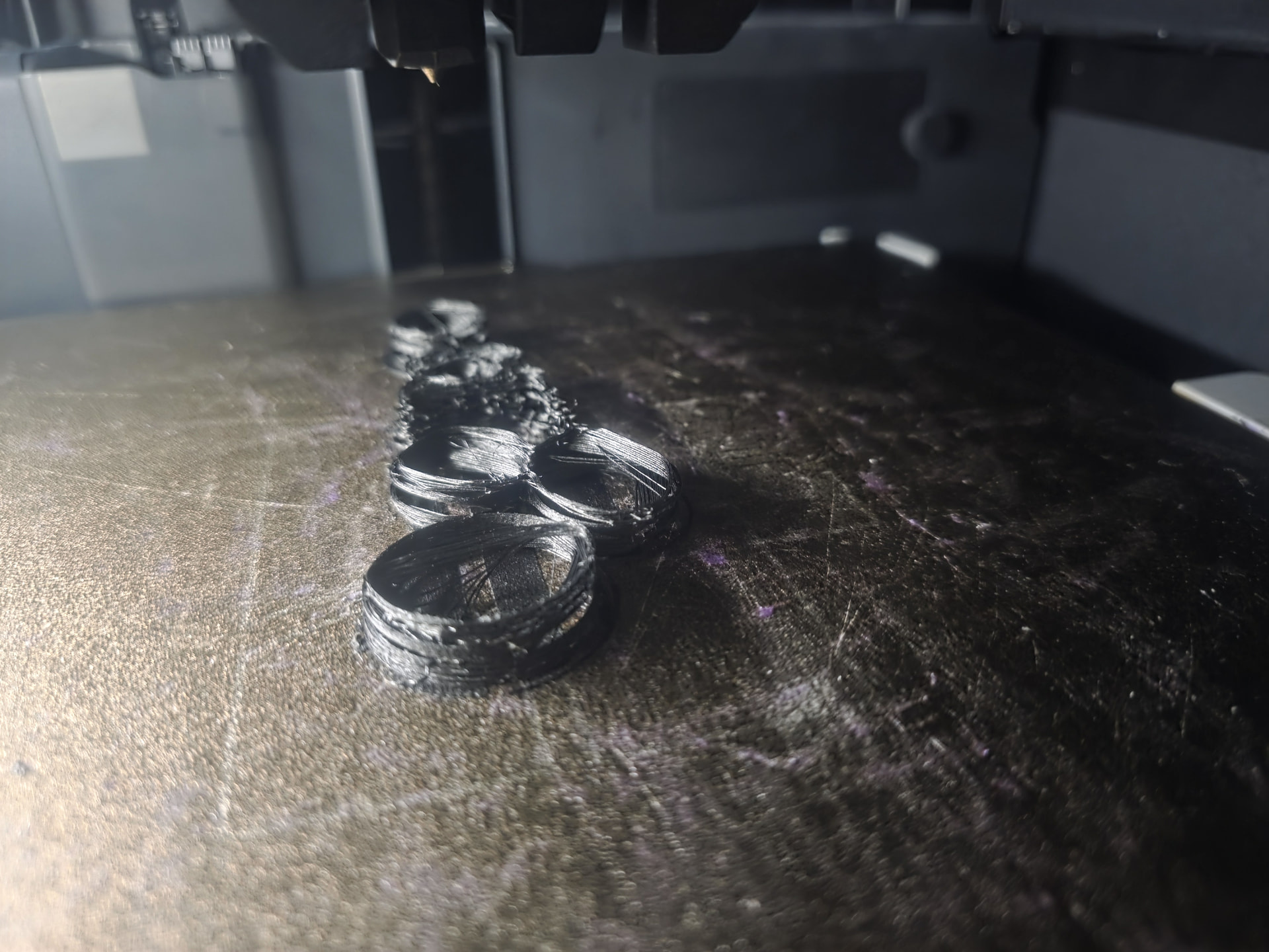

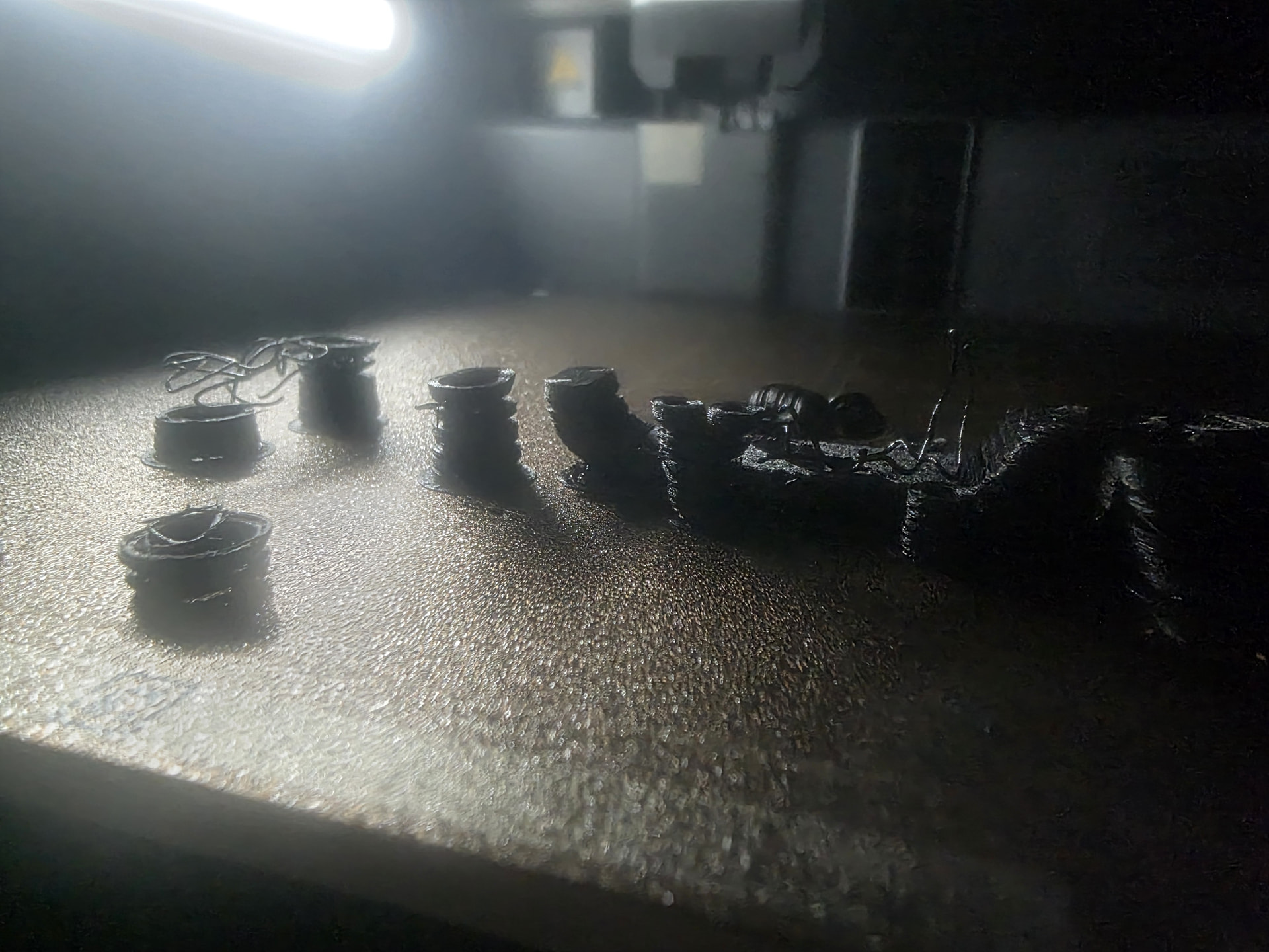

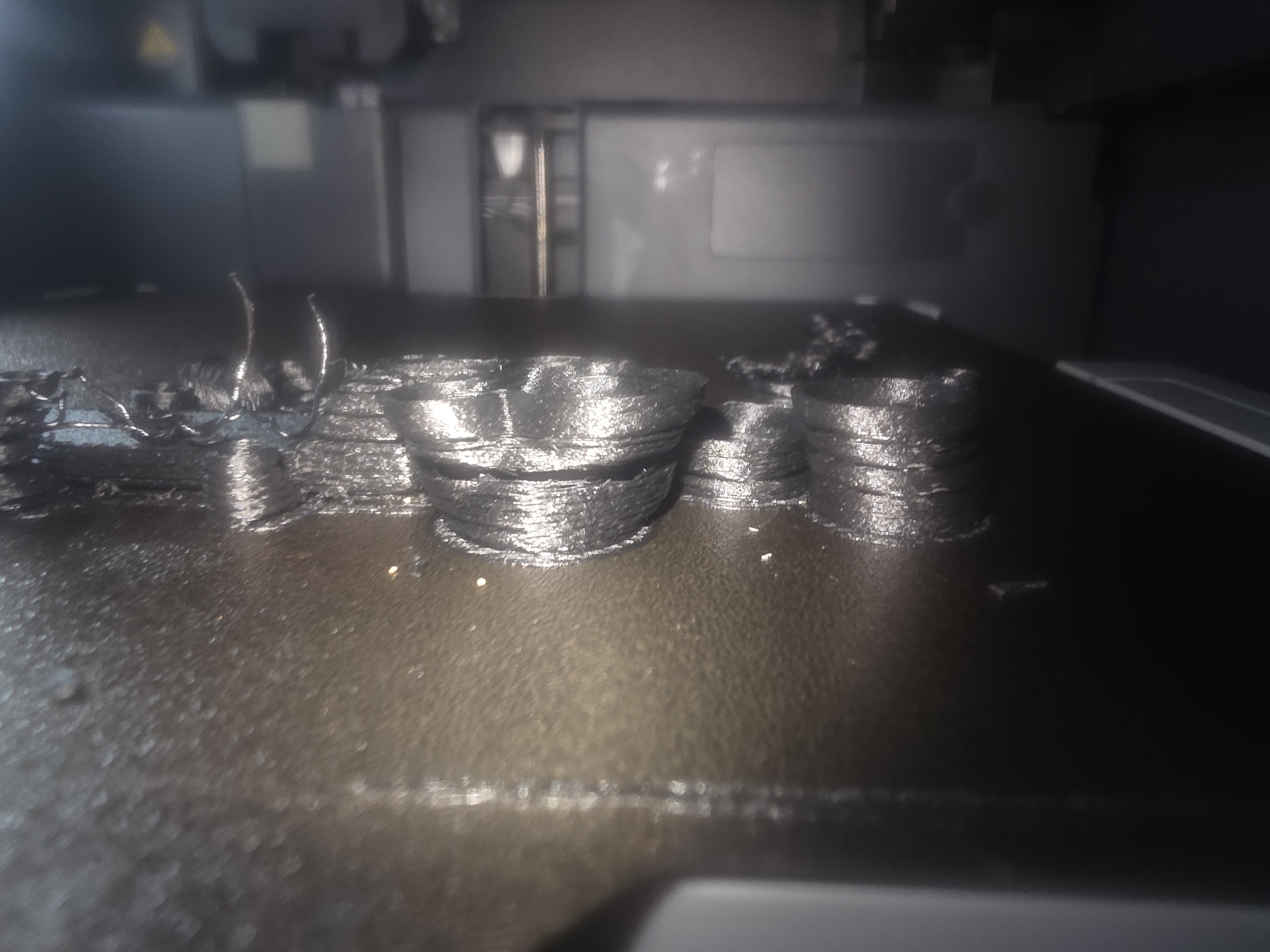

Tree supports breaking during print P1S

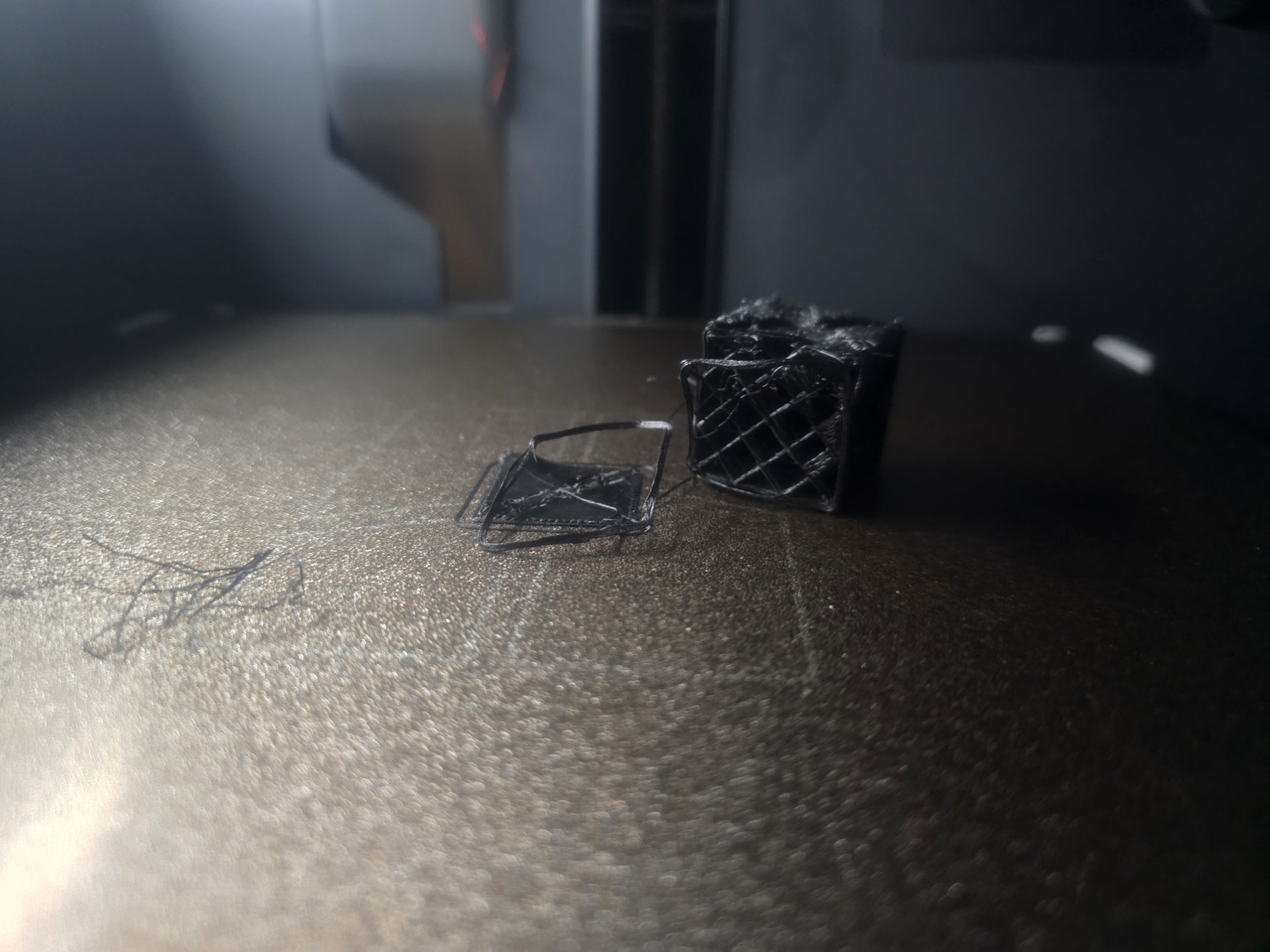

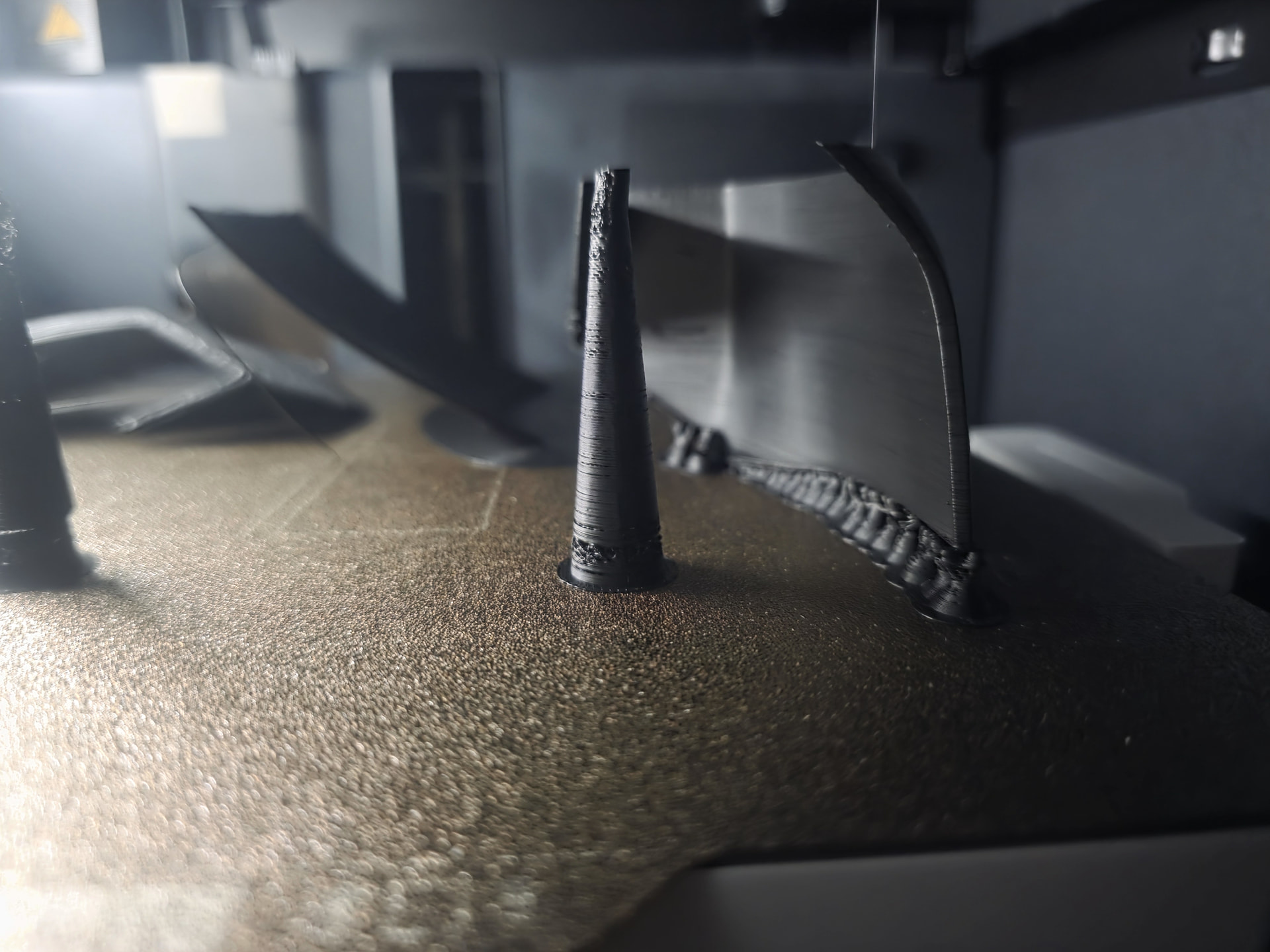

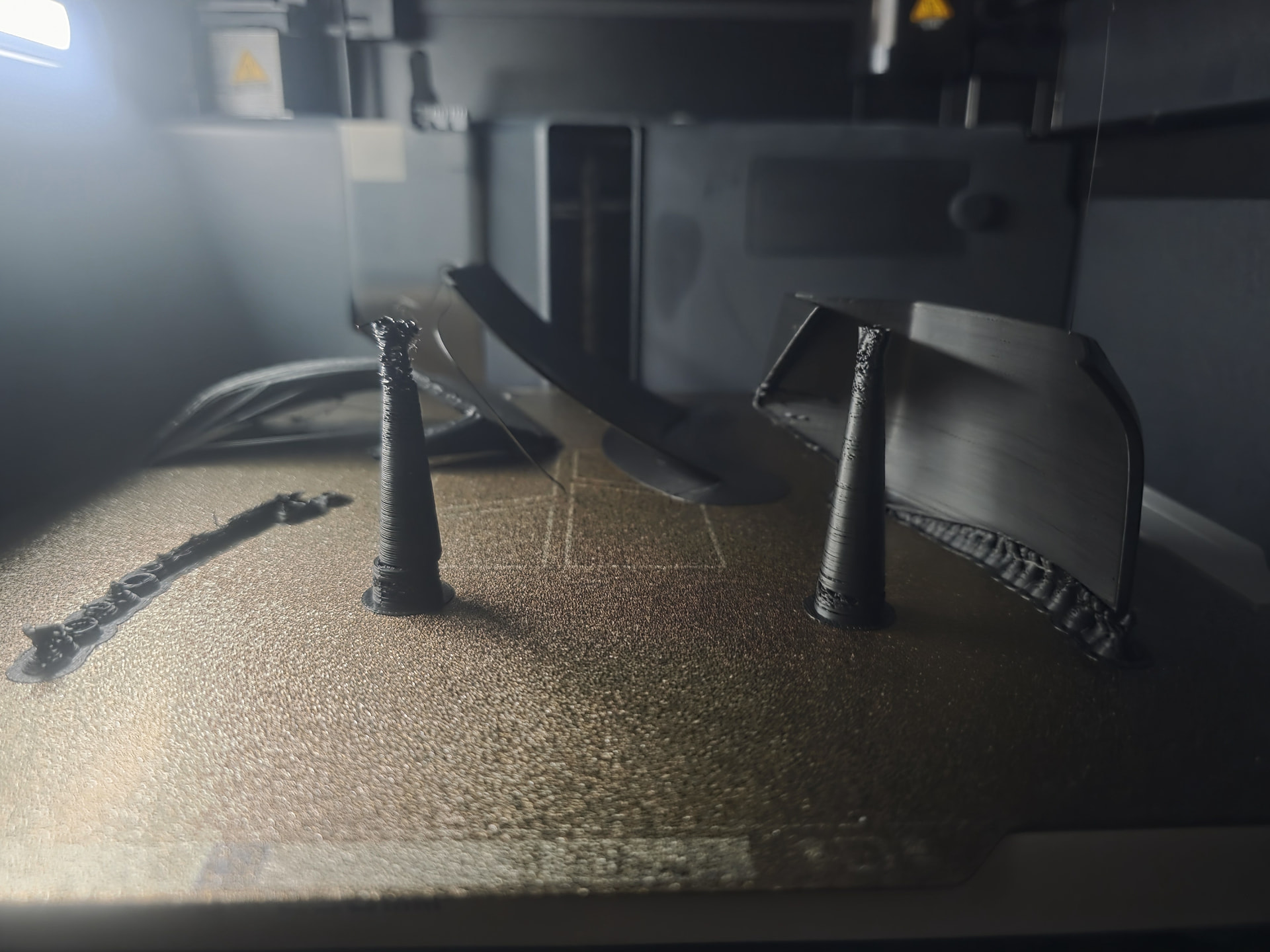

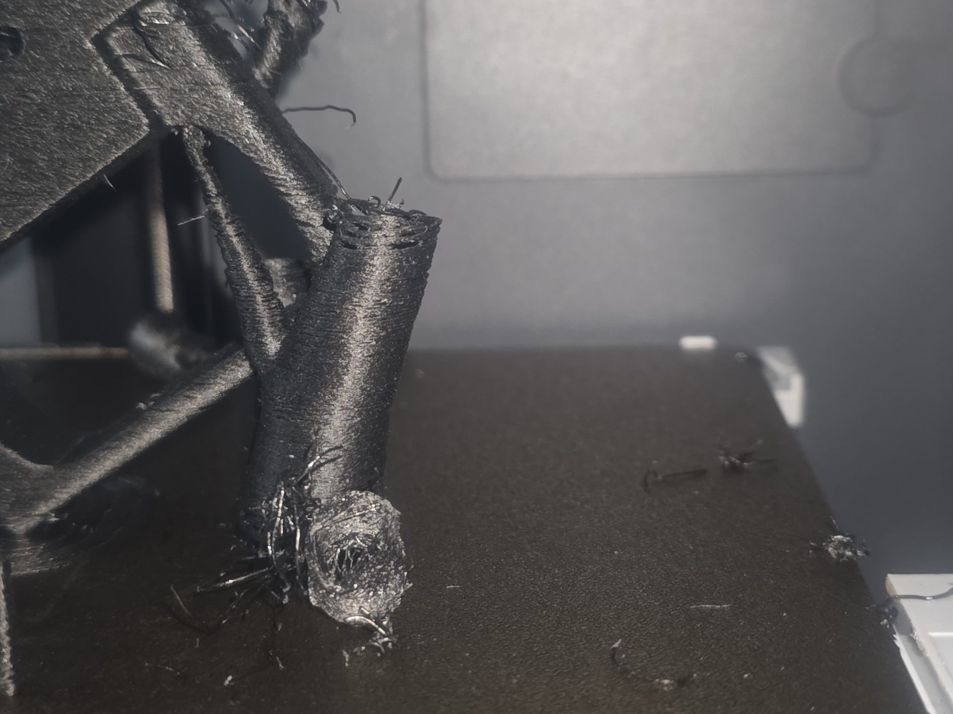

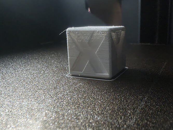

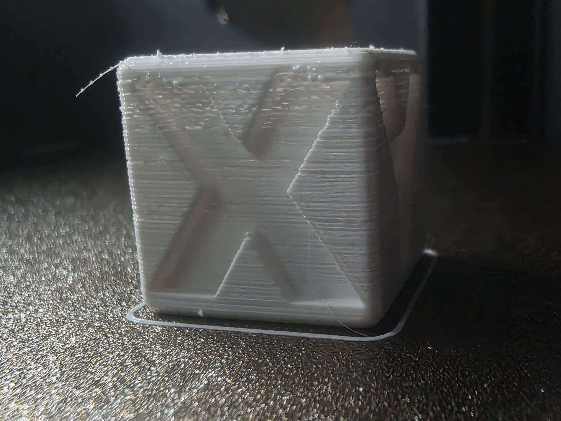

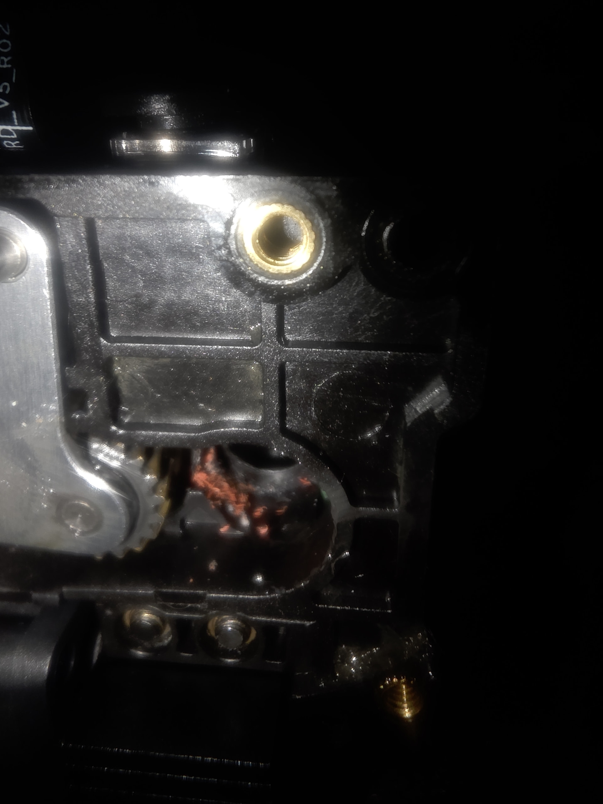

I have been having issues with my P1S for a while. While tinkering things have been improving, the print quality has been spotty during the print. The tree supports break during the printing process. It should be noted that I am using in these photos pet-cf after drying the filament for 6 hrs at 90C, I have also had this issue with pla and petg.

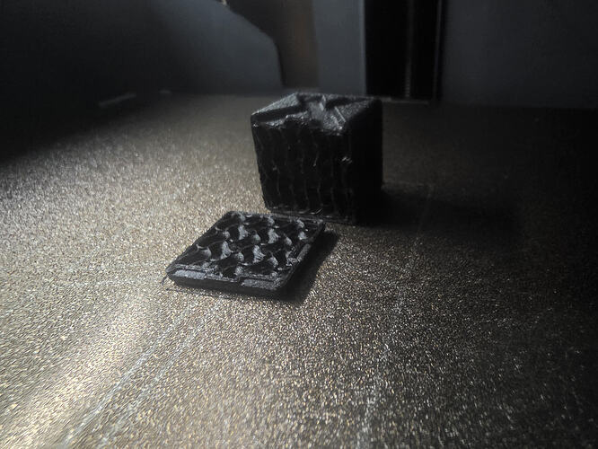

While here, I also want to ask about the quality of prints. The bottom typically is in far better shape than the top, with the quality becoming more spotty as it progresses. It wouldn’t be as big if it wasn’t for the pet-cf prints snaping towards the bottom when trying to remove.

Edit: This was after I slowed down the print speeds by half and dryed the filament.
You clearly have a flow issue. If you aren’t using a known good profile for your specific filament, get one and use it.
If you haven’t done flow calibration and pressure advance (in that order) for this filament, you should do it.

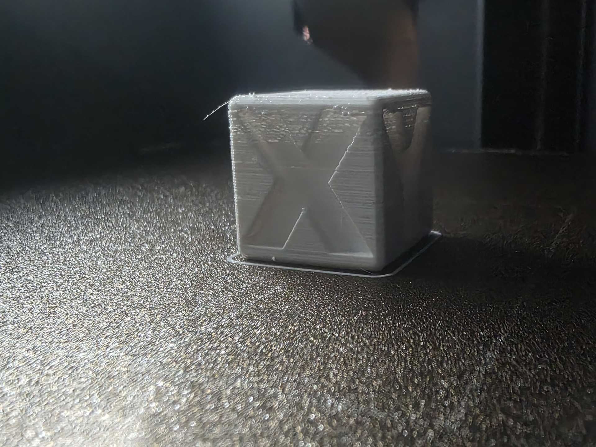

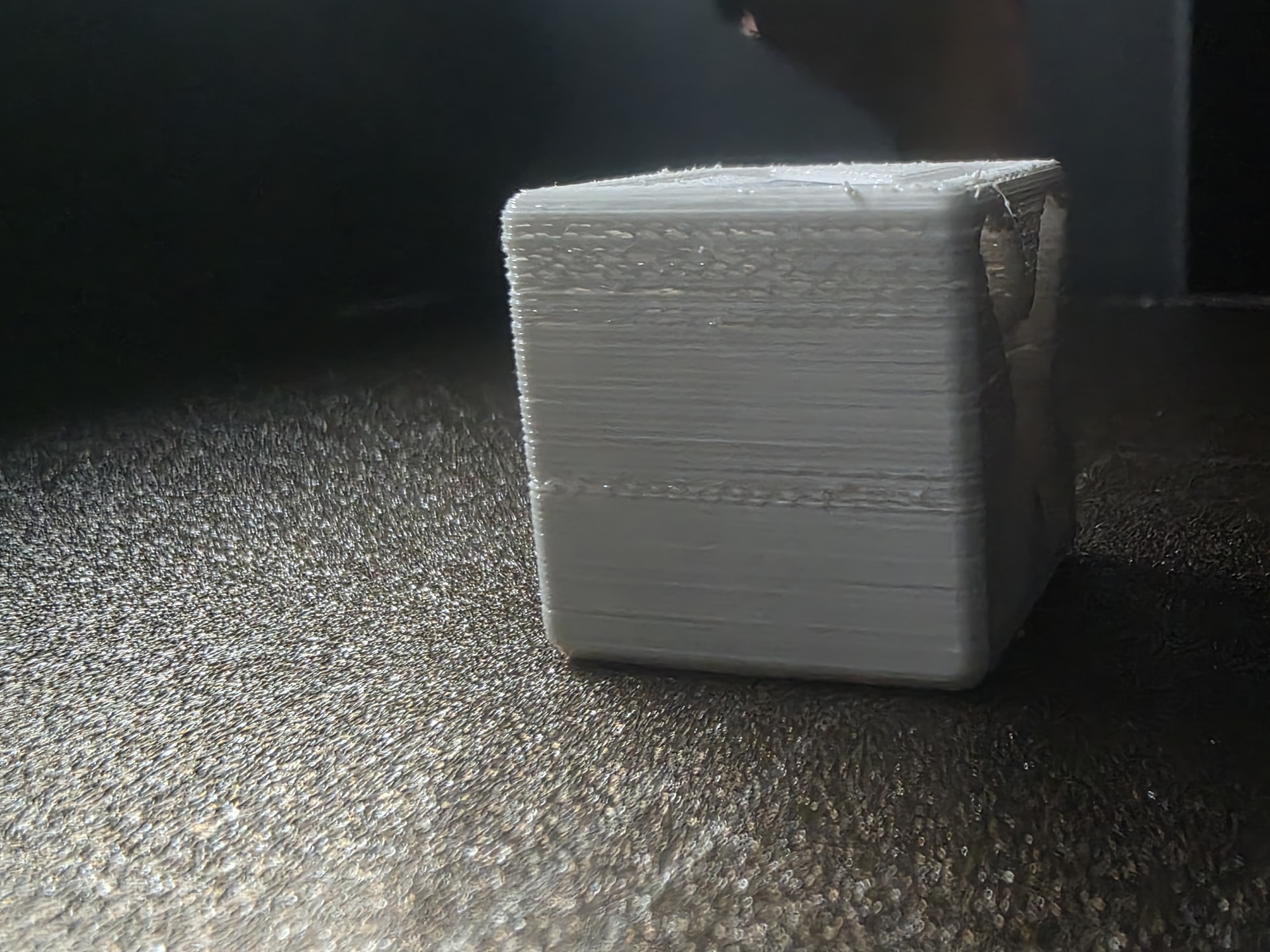

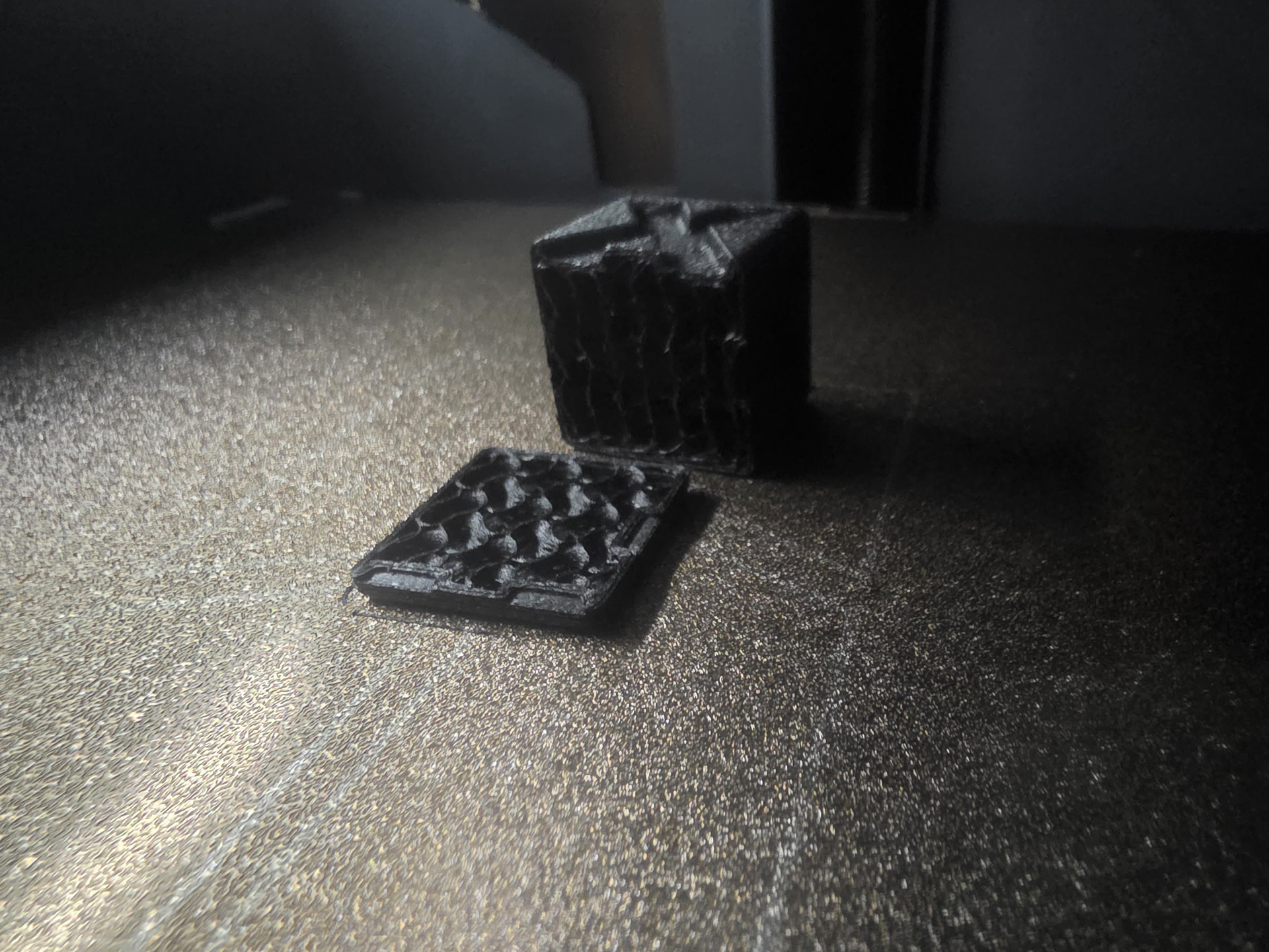

That white calibration cube is pretty bad. Imo youve got a mechanical problem, in the extruder or heater or nozzle. If you have spares of any of those on hand, nows the time (imo). Depending how old the printer is, support might be of help in getting some parts sent.
Currently I have 1 stainless steel 0.4 nozzle (stock), 1 hardened steel 0.4 nozzle (the one I’m currently using because of the carbon fibers), 1 hardened steel 0.6 nozzle, and one Phaetus Conch Plus 0.4 nozzle (worked in begining but had issues and switched back).
Actually, support is already involved… :+1:

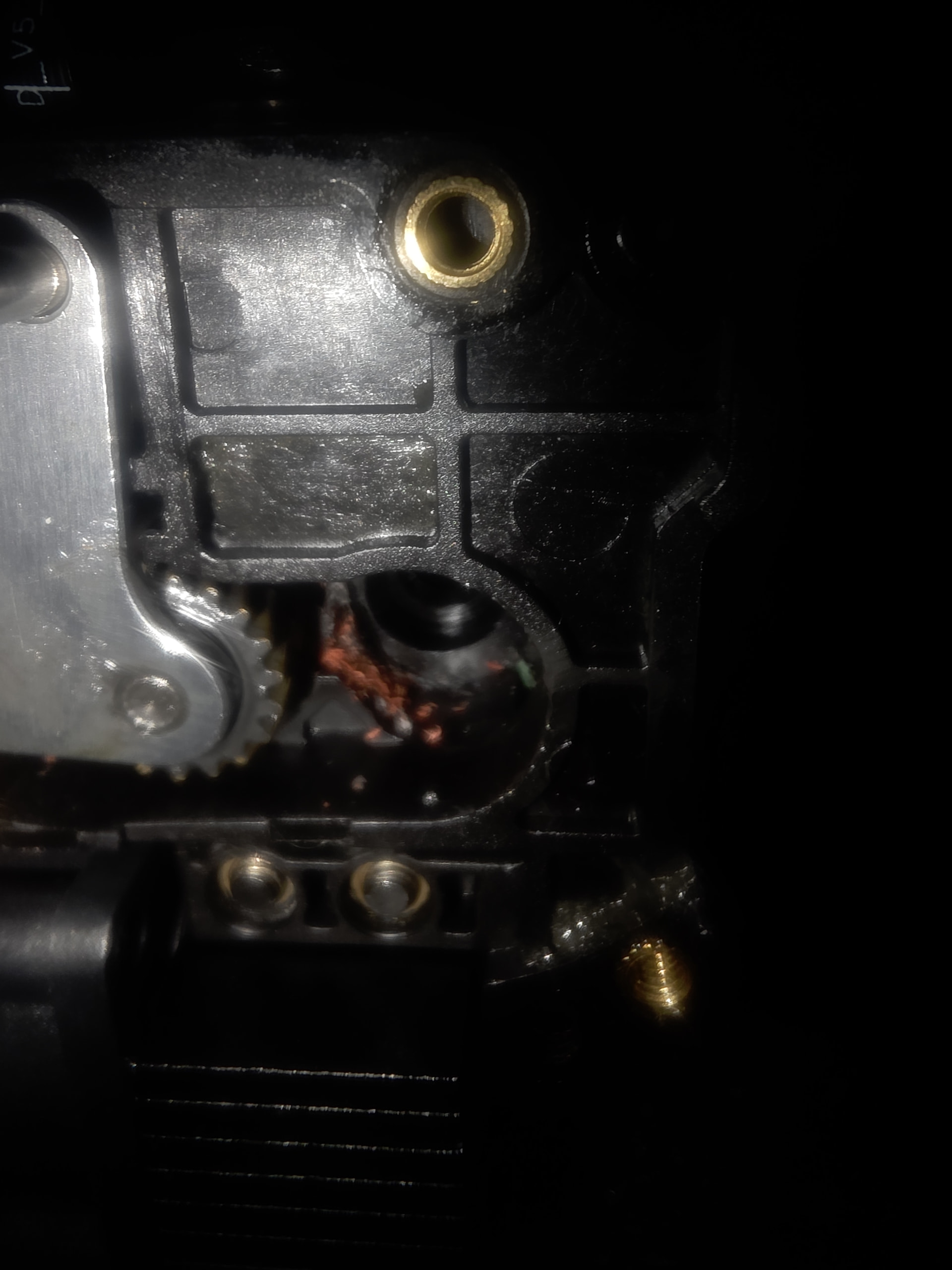

I am still in communication with Bambu Labs for this, switched from a 0.4 to a 0.6 amd still having issues. I am starting to suspect that the extruder might be part of the problem, given the detritus that I had to clean from the inside.

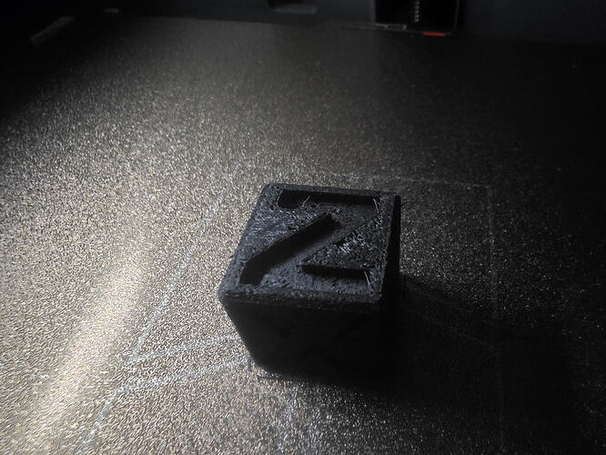

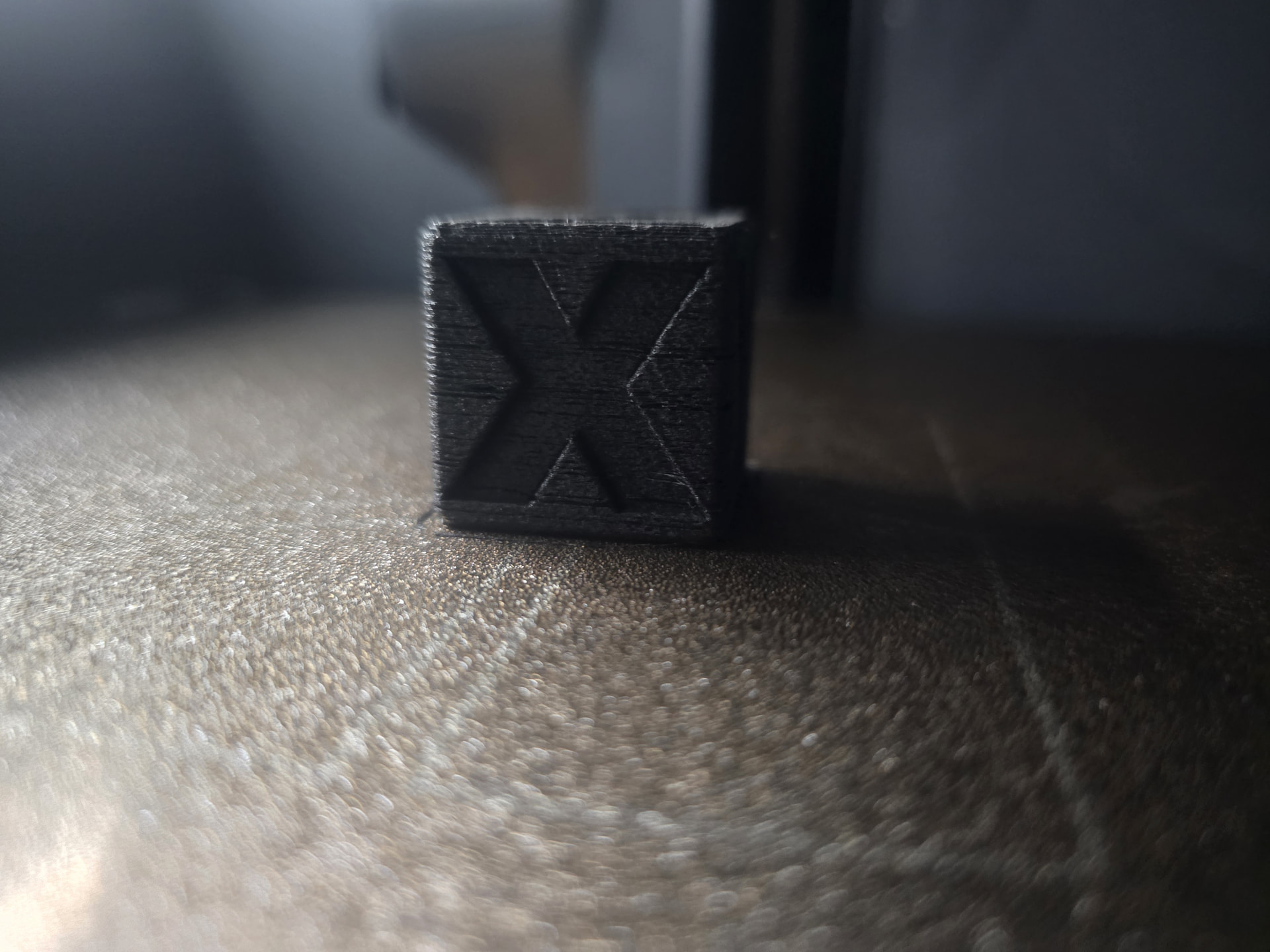

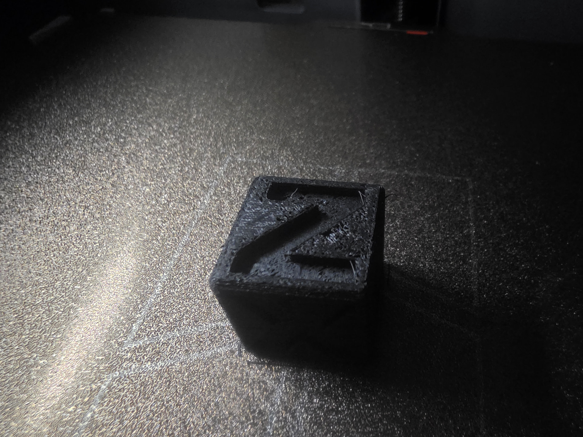

I did get the panda claw as the first upgrade when I got my printer, the gears still look fine though it may need replaced. I am also considering if the panda metal extruder would help too.

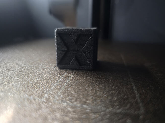

Update: The new extruder and gears came in, I have been testing the prints with PLA, so far they are turing out good. I haven’t yet tried any of the carbon fiber filaments, so we’ll have to see on that. Wanted to ask about the prints. From the sides the calibration cube turned out great, but the top has obvious layer lines. I also printed a piece of armor that mostly turned out fine, exept for what looks like scratches on the side. Do you know what could be causing these?
