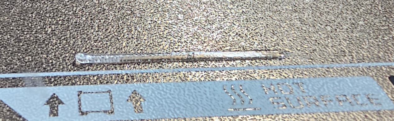

I have some clear pc ill try right now.
I’ve printed extensively with both PC Clear and PC FR without any issues—no problems at all with either the AMS2 or AMS HT.
Have you made any changes to your printer setup? I’m running mine as it came, with the only adjustments being increased nozzle and bed temperatures.
Here you go. This cuts out the possibility of it being a sensor being fooled by transparent filament and also rules out the generic pc profile as being issues. Id say try a different nozzle, manual tune the filament, dry it well, try different pc filament
Generic PC profile. Factory z offset
Overture transparent PC
My temps
110c bed
270c nozzle
65c chamber
My filament tune is
.34 PA
.94 flow rate
16mm3/s max flow rate
Originally dried 12 hours at 65c
If it still doesnt work after these things, start bumping nozzle temp up. If you find it works with a much higher temp, test your actual nozzle temp vs whats displayed on the screen. If those 2 numbers are more than 10c different, contact support. If less than 10c, live with it and learn to adjust temps or do a temp tower.

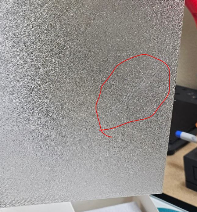

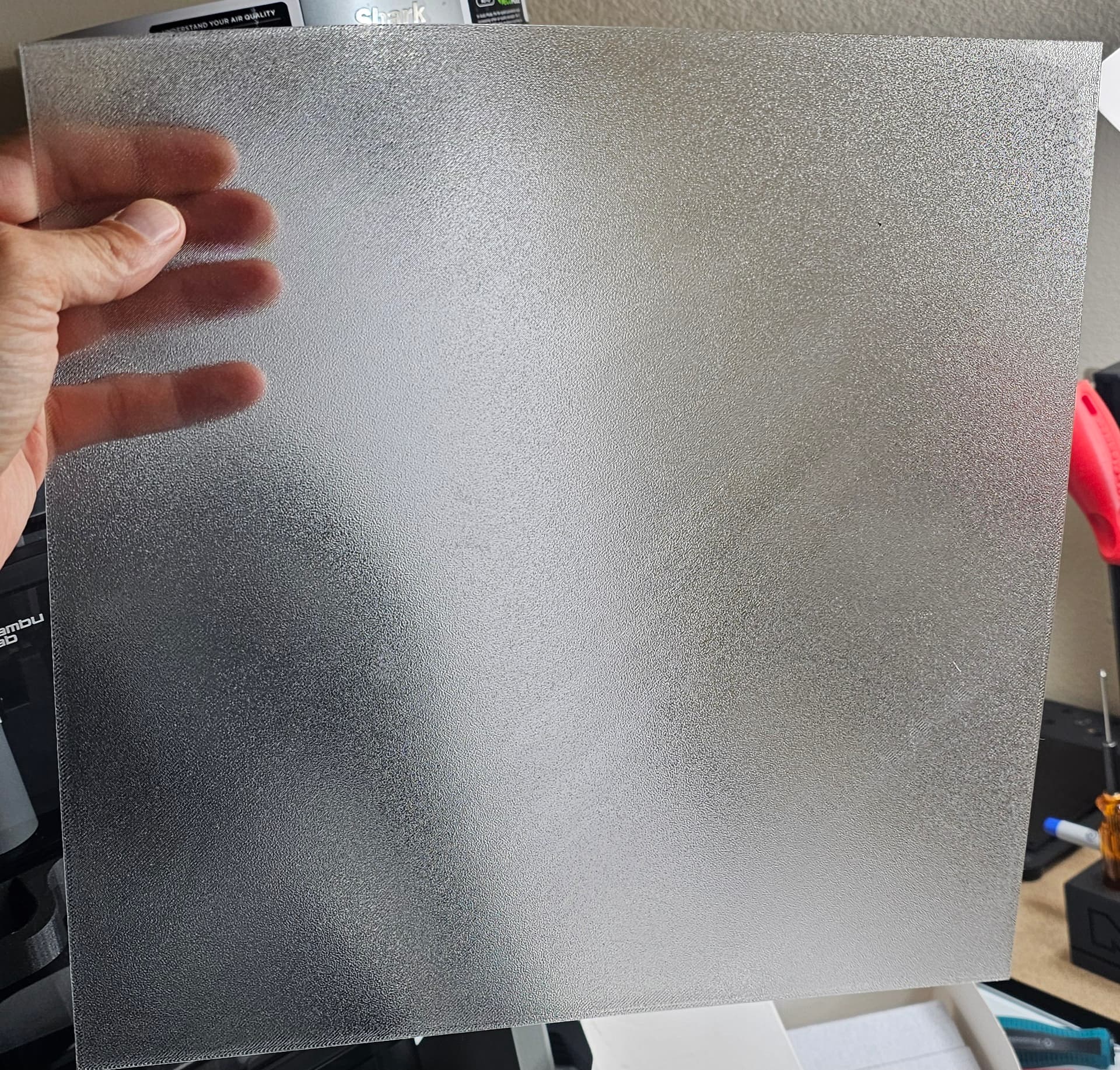

Thanks for sharing your clear first layer PC test. It could be the photo, but here’s what I’ve managed to Z fine-tune out. I’ve eliminated the small layer ripples on the smooth PEI plate when using HF-PETG. However, getting a 100% flawless finish on the textured plate will be more difficult if it’s even achievable.
But this is an acceptable first layer nice job! :+1:
