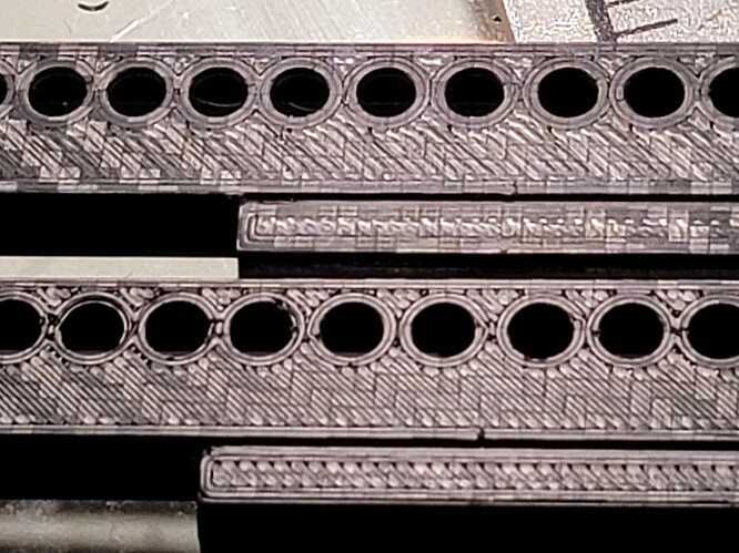

I’m having under extrusion problems too. I only just found this thread. I’m printing Polymaker ASA at 105c bed on P2S (bottom) and P1S at 100C (Top)
I’ll try the P2S at 100c see if it makes a different. I’m really annoyed with the P2S. It’s fine with PLA and PETG. But this ASA has been a nightmare. I got it for my Etsy business, so I could print stuff twice as fast, First layer results have ruined anything that needs a smooth surface printed face down for show.
