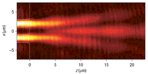

This is exactly what I mean. rovster’s 1.1mm definitely raises eyebrows, but light under a straight edge, a photon, can squeeze through some exceptionally small gaps. Then, once it has, it’s path is wildly hard to trace. You’d need some exotic equipment to measure any of the information here, and even if you did have that equipment you’d better start questioning how many atomic particles of straightness your “straight edge” actually is.
So
Understanding light at the nanoscale: a nano-sized double-slit experiment
… I’m not so sure.
“A way” - Sure. Granted.
As stated before, my point wasn’t to discredit anyone’s concerns. My point is to help folks make sure they’re pulling the correct thread when troubleshooting. Starting with photons that are known to slip between micrometer gaps might not be the correct end of the spectrum.

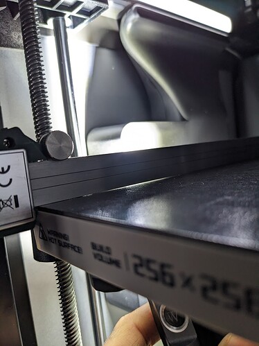

Just for information. In engineering we used a light box and straight edge to ensure flatness of a workpiece to 1/10,000 of an inch which is 0.00254mm. If you aren’t sure that your straight edge is straight, scribe a line along it then flip it over and scribe a line over the first one. If they don’t match perfectly, it isn’t straight.
I could definitely live with 0.2/3 off, but not with 1.1mm. Not the best fade-put could ever compensate that (although Bambu does no fade-out st all).
But with 1.1mm off, nothing will ever stay straight, it will always wiggle. And I can assure you, all my prints wiggle.
My 350mm Voron bed has 0.1mm off, with heat it expands to 0.24 - this is totally acceptable.

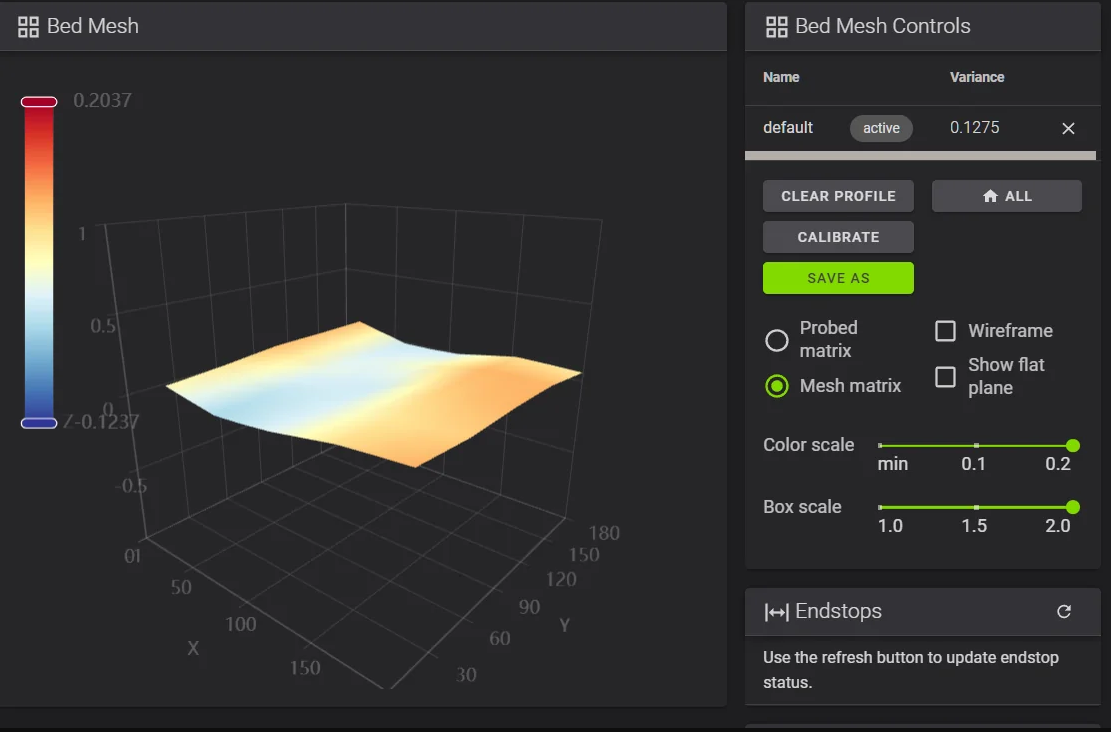

Can you elaborate on the process you followed to find those measurements? I understand how to detect bed warping, but am uncertain about how the measurements are obtained.
You can get this information from the measured bed mesh from the auto bed levelling of any other printer.
Bed mesh: A map with each measured bed point with a measured height value.
As example:
Also Bambu does this but doesn’t provide you with the information.
Well, the reality is: you need no special tools to measure how much the bed is “out of flat”. BL already has a tool built in for that, and it is fairly accurate for the purpose. What you need is just a mesh displayed by the printer or BL studio after it does the probing. :slight_smile:

Check the picture above, I simply measured the distance between the bed and the ruler with another ruler. That easy on such big gaps/warped beds. No light bending interferes, nothing :slight_smile:

A reasonably accurate way to measure surface flatness is with a straightedge and set of feeler gauges. Just find the thinnest one that will not slide under the straightedge.
I just made a new wooden table top for a radial arm saw, approximately 50x100cm. With hand planes and sand paper I managed to get it flat to within 0.07mm before I decided that was good enough.
I’m still waiting for my first printer to arrive so I’m not sure just how flat the Bambu bed really needs to be. It might be more realistic to measure with a shorter straightedge, something just a little longer than the objects being printed. You would not typically print edge-to-edge.

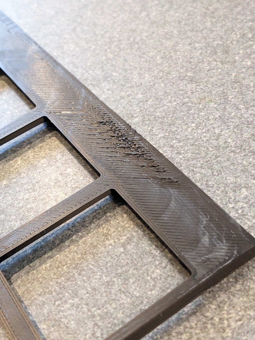

Brand new printer and I have a big high spot on the middle left of the bed. Consistently lead to extrusion issue just around the problematic region. I measured it to about 0.2mm so a full layer height.
Between this and the banding on X axis, the amount of issues I’ve had in a single week with this printer at this price point is unbelievable. I think I maybe have spent less time getting quality prints with my Ender 3 and I’m still not there yet. Seriously considering an FLSun V400 instead…
So sorry to see this! Ironic mode on: Don’t worry, the bed does not need to be that precise! /off
If its “only” this “small” spot, you can try to fill it up/shifting with some tape until you get a new bed. Good luck. My Ticket is still answered, but my other tickets got resolved quickly.
Maybe not an easy fix? Sending out the same replacement beds doesn’t seem to be doing the trick.
Any way to temporarily add a shim to the low areas until Bambu Lab has a better solution?
It’s definitely not that big (25mm radius). But it’s hard to fill as it’s a high spot, I would have to elevate the whole bed some way or another to match it. (The low spot visible on the first picture is a byproduct of the high spot in the center of the bed.
