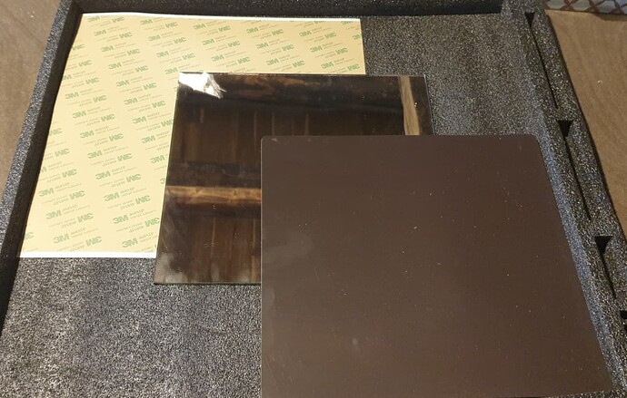

But, depending on what ou already have in spare, you will have to buy a new âgoodâ magnetic sticker and 3M double side sheets.

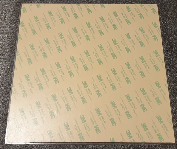

I have used :
- Mirror 250x250 (3mm thick)
- GIANTARM Magnétic Sticker + PEI plate 260x260 (the textured PEI plate is great, I often use it with the Bambulab now)
- 3M 468 MP - 300x300 double side sticker

3M double side sticker can be removed, same as you can remove the original magnetic sticker with a little help of heat.
Once magnetic sticker is removed put/stick using 3M something flat (I have chosen mirror but can be anything that is flat and handle heat) on it and stick a new magnetic sticker on top of that.
You can perform some tests before sticking using 3M double side sticker, if you want to be sure it works the way you want. But there are no much risk, you will still be able to remove/unstick it and try something else.

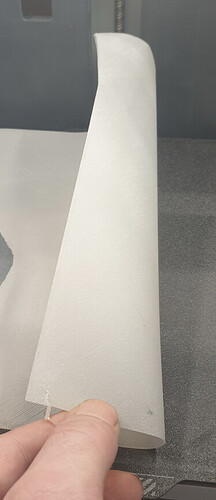

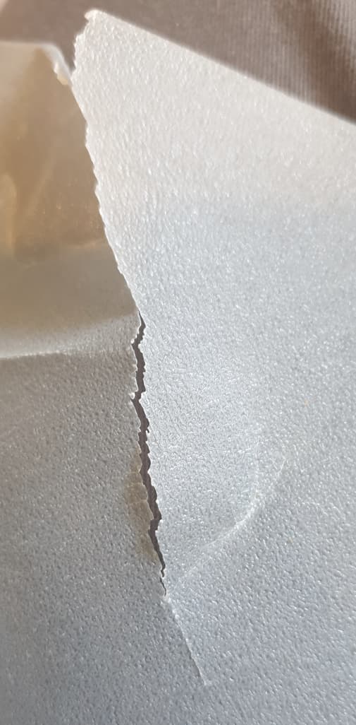

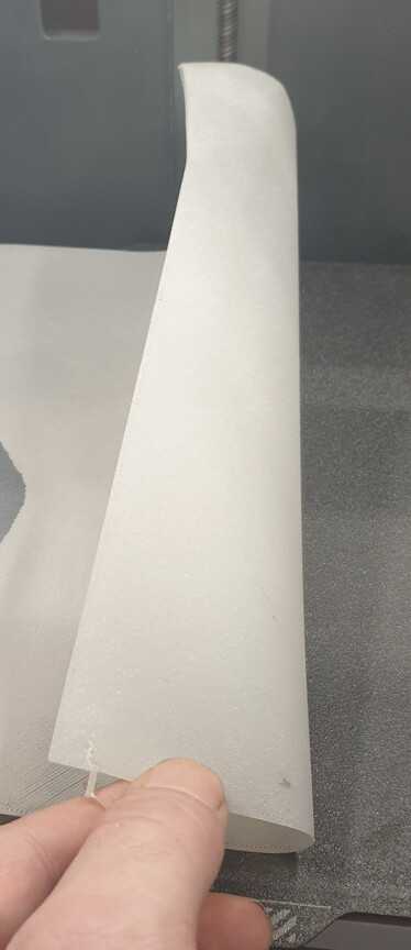

Some more information on heat for mirror + magnetic sticker bed :
This is a 0.1mm thick ABS layer on Textured plate set to 100° :
Dont worry about imperfection, I did not clean the plate for a long time and I have used a two years old spool that was in a big mess with lot of other things.
Interestingly it really look like a paper sheet, it is tearing like paper.

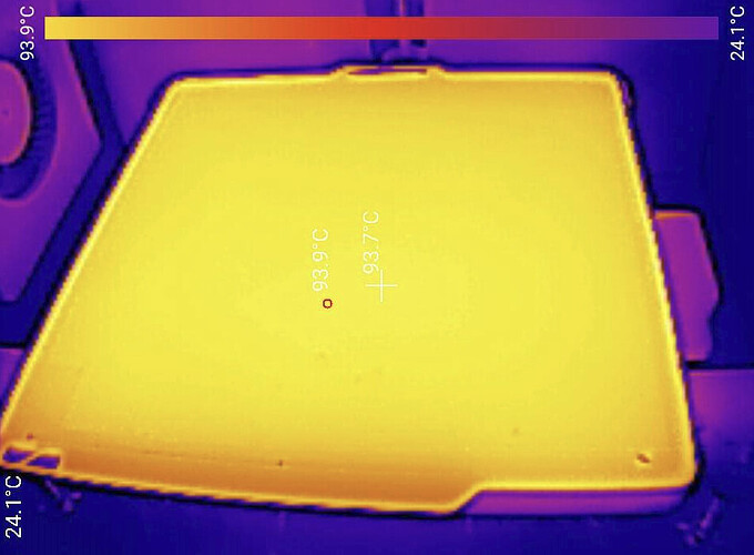

About heat, I have used IR camera and heat look pretty good (about 7°C less than the bed setting value), but due to difference of material IR emissivity/reflexion, values may not be exact, for example plastic looks hotter than the plate.
Thatâs why, I have measured the temperature of the thin ABS layer of plastic rather than the plate as I have supposed that it will be less reflective than the plate (but even plastic act a little as a mirror for IR, I can clearly see the hotend reflexion on the plastick layer when I am filming the plastic layer with the IR cam, wich is obviously not the case with a standard camera).
One thing noticeable with this thicker and more heavy bed is that it introduce a bit more heat phase shift, which is a well know phenomena in insulation study. This is the time the heat need to go from the heater under the aluminium plate to the top of the bed, basically it require a little longer to the heat to reach the top of the bed (not that much, not enouhgt to be a problem), this result in the fact that what the printer display as the bed temperature is not exacly the heat of the top of the bed, but it is already the case with printers beds in general.
Another thing noticable is that with more mass it require a little longer to cool down, once again not enought to be a real problem.

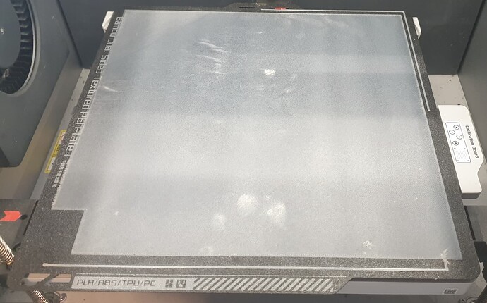

How many mm deviation do you have now? Can you still see light under a ruler when you put it on the print bed?
From the higher point to the lower, I think there is about 300”m.
With a ruler the bed looks like perfectly flat, it is a bit tilted due to the 3 lead screws which use only one motor and belt and should be leveled by hand, see : Manual Bed Leveling / Manual Bed Tramming | Bambu Lab Wiki
Note that I get different results depending on the PEI plate and how I set it in place.
Overall I will say I have a maximum of 100”m/150”m of real deviation/warping depending on plate, (not counting tilting)
