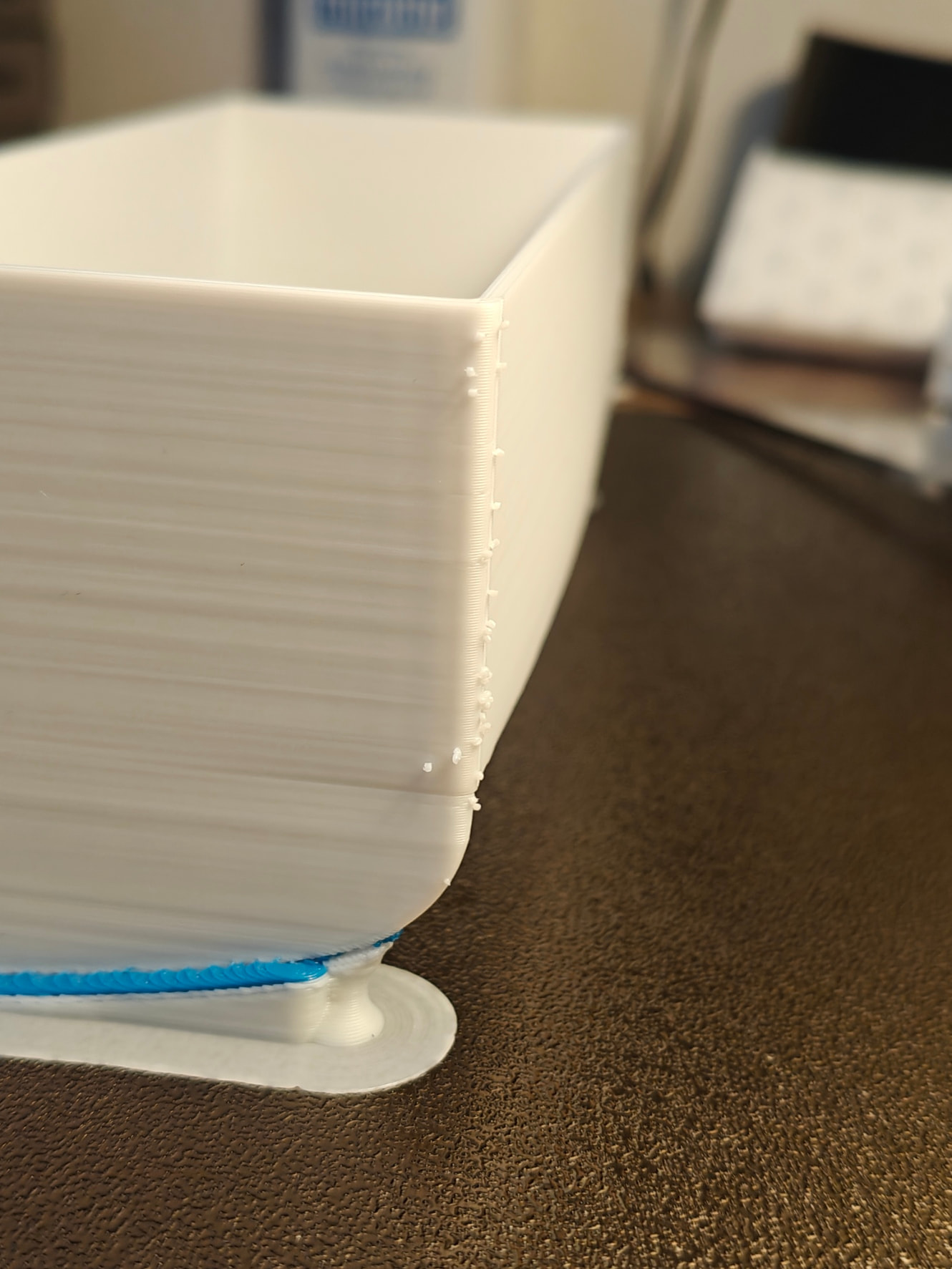

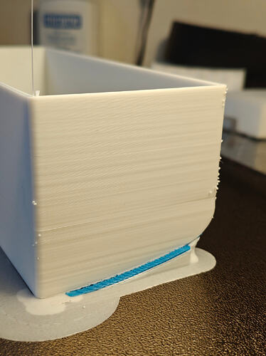

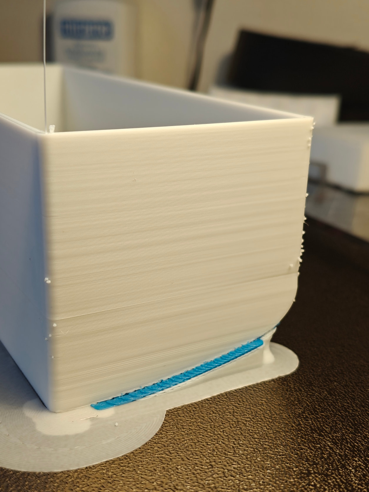

Here are some prints I did today after applying the calibrated Flow Ratio settings to BBL official PLA Basic profile. I must say I’m not impressed, even after doing both manual and automatic Flow Dynamics calibrations and drying the filament and this is the result?

Looks exactly like the issues I’ve been struggling with too, with inconsistent layers. On top of that, I also experience over and under extrusion in the same prints.
I created a support ticket with Bambu, and I must admit that so far they’ve been really responsive and supportive, so kudos to Bambu for the support provided so far.
Anyway, they immediately recognised and admitted that these are indeed the issues. So far, I’ve followed their various pieces of advice and printed quite a few test models, but nothing has helped yet. The prints still look very bad.
The ticket is ongoing, so let’s see what’s going to happen.
