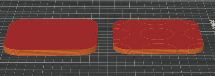

Consider a 8.25”x8.25” rectangle that’s 13mm tall. It’s large enough that with default slicing, some amount of warping/curling might happen.
Starting with the integrated brim:

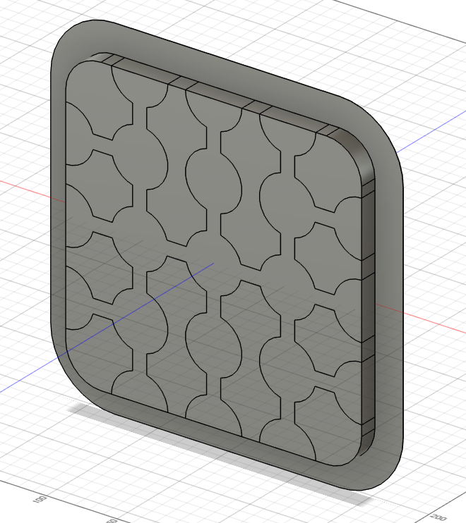

the idea is to break up any long lines in the print that might lead to warping/curling by breaking the model into two parts, one nested inside the other:
The final print looks like:
I previously did this using print modifiers. This is my first time doing it by creating a nested model in fusion360 that prints as a single monolithic model, but with a lot of internal structure aimed at defeating warping/curling. I’m in the midst of printing it now:

As for the model, it’s just two pieces:
that fit inside one another with zero clearance:
which you then export. When you import it into Bambulab slicer, it imports as a single object. Position it where you want it printed, then do a “split” to break it into the two objects, which remain in position and are then ready for printing. Despite being separate pieces, the zero clearance means they fuse together during printing to create a monolithic piece as the final product.

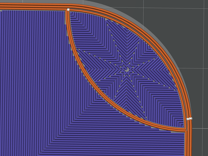

I did notice one weird thing, though, which is that on the initial layer the Bambulab slicer inserts a gap between the walls of the two pieces. It doesn’t do that on the subsequent layers, and I don’t understand why it is doing it. I also haven’t decided whether it’s a bug or a feature in terms of anti-warp. Maybe somebody here can shed some light on that?

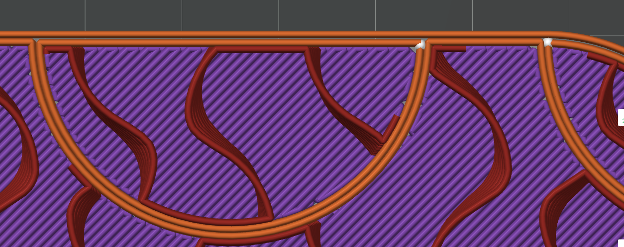

I traced the initial layer gap between walls to two factors:
  1. Elephant foot setting. Reducing it to zero helped close the gap. This nearly solved it, except for #2 below.
  2. The slicer seems to allocate space for the bow-ties used in gap filling on the initial layer. Not sure yet how to disable that. I can’t seem to turn-off gap filling either as a workaround, let alone doing it only on the first layer.
So, some improvement, but so far that’s as far as I’ve gotten. All this in Bambu Studio. Maybe Orca Slicer might offer an escape. I’ll try printing it. Maybe what remains will make little difference, or maybe it will just flow together anyway with the elephant foot compensation disabled.
Hmmm… Looks as though that bow-tie gap persists in subsequent layers also:
I have little to no reason to care about filling gaps on the internal structure anyway.
[Edit: I guess it’s not the bow-ties after all, because they don’t seem to have that spacing effect on the internal structure:
So, I gather some other factor is in play. On the other hand, it does look like there’s some kind of setback operating when there is a seam, because in the same area where there is no seam, there is no gap between the walls, as illustrated by:
[Edit 2: Watching it print…. It’s exactly like the preview, even with elephant foot disabled. True WYSIWIG. Maybe it’s because I use a tuned initial layer flow rate, so maybe that effectively renders the elephant foot compensation irrelevant.
The mystery persists….]

Reporting back: The solution to the wall gap problem turned out to be ridiculously easy. In Bambulab Studio slicer, simply Split into Parts instead of Split into Objects. Problem solved.
Using Split Into Parts maintains the relative position of parts, so I can now get a perfectly smooth bottom as well. It was the missing piece, so obvious in retrospect.
