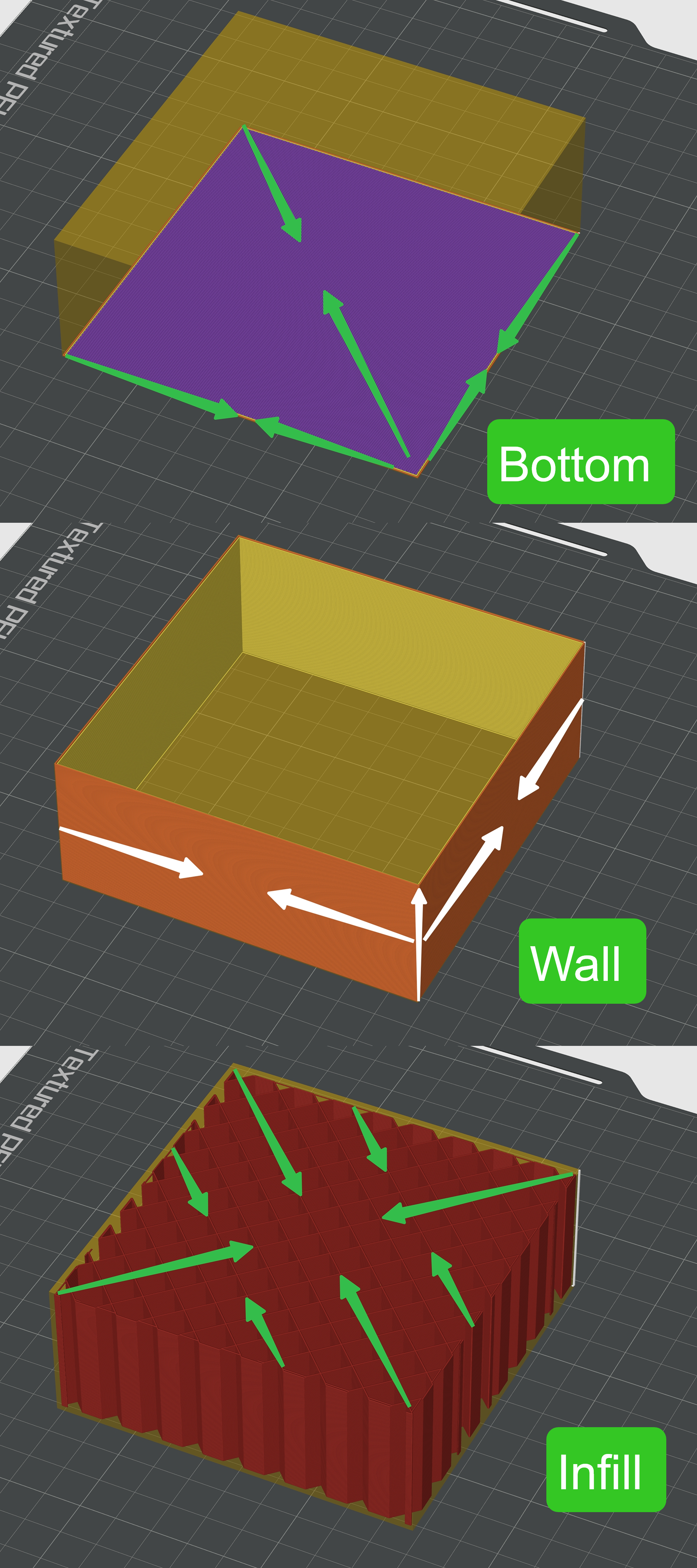

What makes warping happen?
Let’s start with the filament: the extruded filament shrinks as it cools, getting shorter. The image below shows that the filament shrinks as it cools after extrusion. The values shown are examples only. Actual shrinkage varies by filament type and print settings.
Let’s look at a cubic model now: when looking at the toolpaths, a cubic model breaks down into a top surface, a bottom, walls, and infills. They all use similar print path patterns.
The stress from shrinking usually builds up at the bottom edges as the filaments cool. You may have noticed they particularly occur on edges and corners. At these spots, the shape limits the shrinkage. This leaves limited space for the material to contract.
The stress from shrinking passes through the layers to the first layer. The first layer is in contact with the print bed. The adhesion between the first layer and the print bed works against shrinking and the shape changes it causes. When the adhesion is not strong enough to withstand stress, the bottom begins to curl up and peel off the print bed.
You can see how the bottom, the walls, and the infills tend to shrink in the image below.
