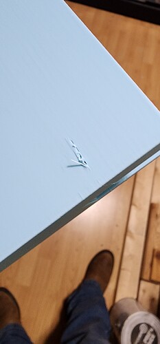

So I keep getting these random flaws when printing with Matte filament (Bambu, Elegoo, ESun brands) They occur at random locations and random heights. Using standard BL Matte and Generic Matte (both w/ calibration done) profiles. Errors are occurring on multiple printers too, so I don’t think it’s a printer specific issue. Anyone have any ideas? It’s driving me nuts!
Not sure at all on the purple one, maybe a blob on the nozzle there.
The others look a bit like the print may have lifted off the bed, is there any warpage on the bottom?
Might help to have some more visibility of the issues, like the top middle one in your picture.
Look, I don’t mean to sound negative, but this picture provides little value without context. Showing a zoomed-in blemish doesn’t accomplish much. For meaningful feedback, you need to provide context. What model was being printed? What did it look like in the preview screen, and what did it look like at the layer where these artifacts appeared? These issues could be model-induced, related to how the model was positioned on the build plate, or caused by a dozen other factors. The bottom line is, if you want a quality answer, we need more information than just a 2 cm blip—or is it a 20 mm blip? :wink:I can’t tell.
No, no warping on the print at all.
It’s a model of mine that I’ve printed successfully about 150 times in the past 8 months, the issue is a recent one, and only occurring with Matte filament.
Same as it’s looked every other time I’ve printed it without having these issues, including printing it in Matte filament previously.

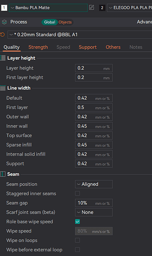

Not quite sure what you’re wanting me to share since it’s happening at different layers, different locations, and is a new phenomenon. Nothing has changed in the print settings (below) which have been used many times without the issue. Sharing the full model doesn’t help since location is random, like on the left side at layer 95, then on the top at layer 700, then on the back at layer 15. It’s literally all over the place.
Screenshot 2024-12-16 230843
Screenshot 2024-12-16 231003
Screenshot 2024-12-16 230940
