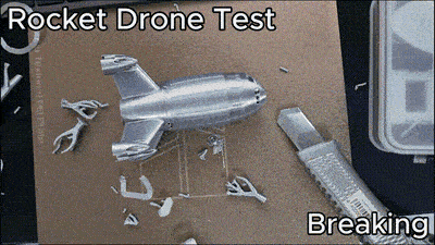

  • Insert mode (beta), for a part that came off the plate or broke. It prints a low holding wall that follows the part’s sliced outline, then pauses. You place the part back in the wall, press resume, and it prints the missing section on top. If the upper section needs supports, it rebuilds them from the bed first, skipping the ones that would be in the part’s way.

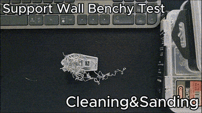

  • a Benchy that detached,
  • a drone body I broke on purpose (the GIF above),

The write-ups also cover what went wrong. For example, I entered the wrong layer on the dragon, and the Benchy slipped without glue.

  • In insert mode, how well a part sits in the wall depends a lot on its shape. Parts that widen towards the top may need a bit of hot glue on the outer side.

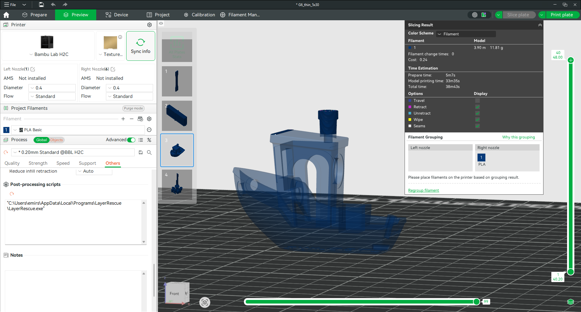

I installed this with an H2C and had some problems with it. I ended up splitting the original model and just printed the lost half. Nice attempt tho! I would think a modification for the different print chamber sizes wouldn’t be too much of a problem to fix but I am not a programmer. Also, is there a layer number I can identify from the LCD screen on the printer somewhere for the last one laid? You seem to ask that for input data (I did go with my measured height instead).
Thanks a lot for trying it! H2C isn’t tested yet, and you’re probably right about the cause: the start, park and purge moves were tested for the P1S, so a printer with a different chamber and layout can trip them up. If you still have it, could you tell me what went wrong (which mode, what the printer did, any error message)? A sliced file would help even more. A GitHub issue is perfect, but replying here works too. And if you’d be up for testing H2C support with me, I’d be happy to credit you in the README as a contributor.
About the layer number: as far as I know, the P1S screen doesn’t show it, at least not in a way you can read after the print has stopped. You’re right that the app asks for a layer number, though. You can work it out from your measured height: divide it by the layer height. For example, 12.8 mm measured with 0.2 mm layers gives layer 64 (12.8 / 0.2 = 64). If your first layer is thicker than the rest, subtract the first layer first and add 1: with a 0.2 mm first layer and 0.16 mm layers, 10.12 mm gives (10.12 − 0.2) / 0.16 + 1 = layer 63. I’m working on letting the app do this for you, so you’ll just enter the measured height.

Quick update on the H2C: I went through the G-code it produces line by line, and you were right that the P1S moves were the problem. I compared it against a real H2C slice and Bambu’s own H2C start G-code. Here’s what I found:
  • The purge station is in a different place. Layer Rescue drove to where the P1S purge chute is, and on the H2C that spot is on the bed itself, so the purged filament would have landed on the plate.
  • It also moved to where the P1S filament cutter is, which doesn’t exist on the H2C.
  • The H2C selects a hotend together with the filament, and its two-nozzle temperature commands have to name the extruder. Layer Rescue did neither.
  • The purge ran faster than a 0.2 mm nozzle can actually push filament.
All of that is fixed now. The H2C has its own sequence built from Bambu’s own moves: purge and wipe with the printer’s built-in commands, and the job’s own filament/hotend selection lines copied from your file. I then went through every printer in the current Bambu Studio the same way (H2D, H2D Pro, H2S, X2D, P2S, A1, A1 mini, A2L, X1 series, P1P), using a real slice and Bambu’s templates for each.
It’s in version 1.1.0. On every printer except the P1S it’s still marked untested until someone actually prints with it. If you’re still up for it, an H2C test print would be the most useful thing right now, and the contributor credit offer stands.
