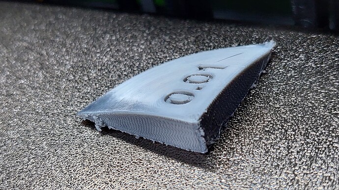

So what are we actually seeing?
The lowest row is, from left to right, printed with nominal layer heights of 0.1, 0.05 ,0.025, 0.0125 and 0.006mm. I aborted at 0.006 as it was obvious that this was not going to end well. I realised that there was an unfortunate misconception in the GUI-user interaction during this test series and could not be certain that results were valid (*). So I repeated the most interesting data points, the 0.0125 and, accidentally, the 0.003mm.
==> Turned out the first row was valid. 0.025mm worked well, 0.0125mm was a close but nevertheless clear failure.
(*) OK, I screwed up in having overlooked that Orca defaults to a Cool textured plate… which I don’t even own… amazed it still worked…
Having already determined that flow control is the key parameter for failure at extremely layer heights, two obvious parameters came to mind when trying to avoid messing with the full object flow ration:
  • Increase the speed
  • Increase the wall width
That is the middle specimen. It is always a bad idea to change two parameters at the same time…
The second row from the top shows the same as the ones below, only that this time, only speed and accelerations were increased by a factor of 2. With flow issues being audible early on, I chickened out again.
The top row shows 0.0125mm and 0.006mm layer heights with a wall thickness increase by 50% to 0.33mm.
What can we take away from this?
  • Halving the nozzle diameter does not actually do anything to improve the achievable z-resolution. In fact, with the reduced flow through a smaller nozzle, flow control can only be expected to be more difficult with a smaller nozzle than with a larger nozzle.
  • Increasing flow is key to achieve extremely fine layer heights.
  • With the failure mode drastically changing from the ribble effect associated with minimum flow to a very different edge exfoliation type attributable to local overextrusion at shallow outer edges, there’s either a tipping point or optimum value in between 100 and 150% wall thickness. If such a processing window is actually wide enough to be useful is not currently clear.

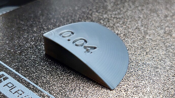

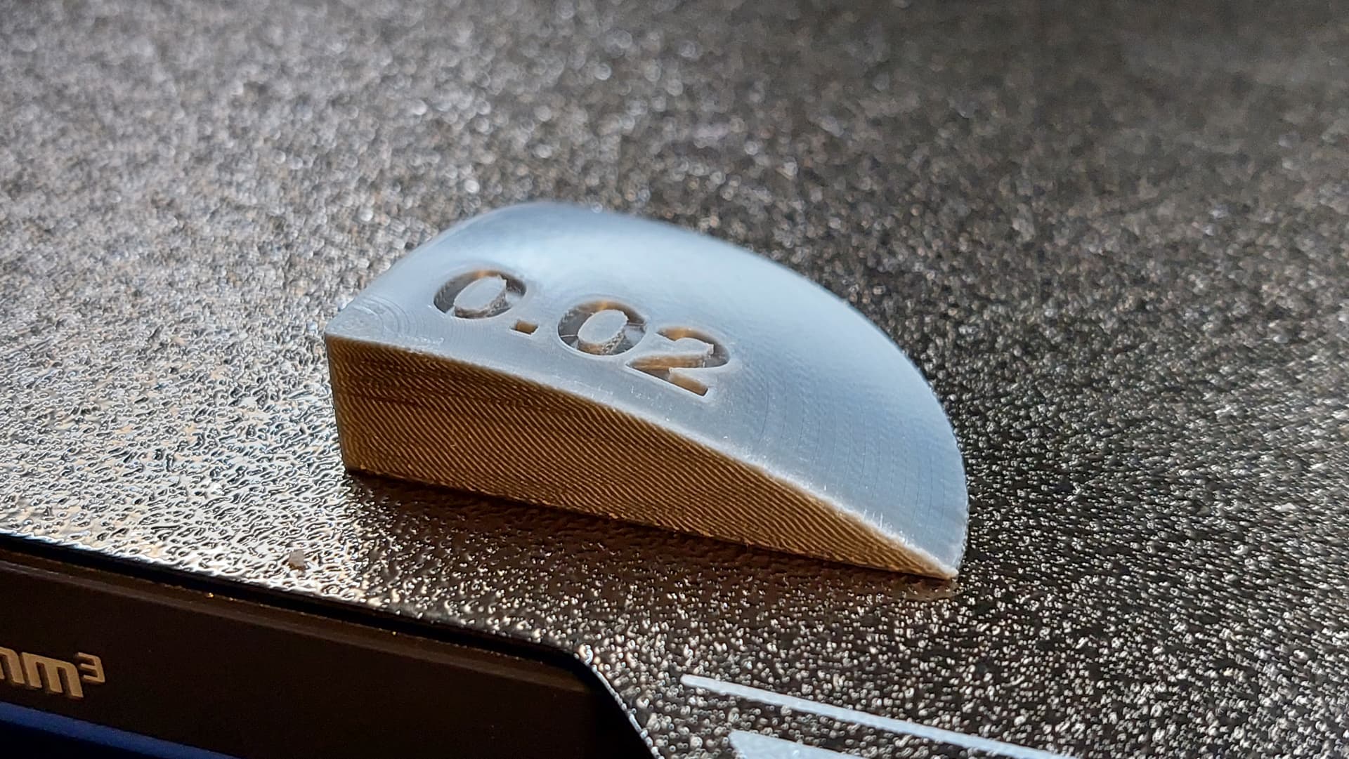

3 Months later, I felt comfortable enough for a quick test.
Using the expected underlying z-axis motor step/spindle pitch increment of 0.04mm, I printed my lenses again at 0.04, 0.02 and 0.01mm layer height with default settings and Bambu Silk PLA (to better show defects). I only used the 0.4mm Vortek nozzle for this quick test run.
The 0.04mm layer height was really nice. Barely noticeable layer ridges when using a fingernail, good wall performance but some minor optical “defects” from flow dynamics control at the sharp edges. I am not sure they would even show with PLA Basic.
The 0.02mm layer height was even better on the top curved surface with the layer lines no longer being able to be felt, but there were obvious flow (control) issues on the straight walls. Still, way better than my X1 at this z-resolution.
The 0.01mm layer height resulted in a really shiny top surface. Certainly on its way to a mirror like surface. Flow control issues were however locally visible on this surface in the form of minor waves. And of course quite severe on the vertical walls.
A recurring phenomenon is the edge corner warping. I currently speculate that this is primarily due to the extremely fast cooling of extremely thin layers in the vicinity of the bed heated first layer.
PS: Bugger: Just realized I should run the 0.02mm (and maybe the 0.01mm) again at higher speeds and with increased line width as in my first run through on the X1… :joy: And maybe lift the 0.01mm lens out of the heatbed affected zone while disabling fans… Hope it does not take a year this time round :joy:
