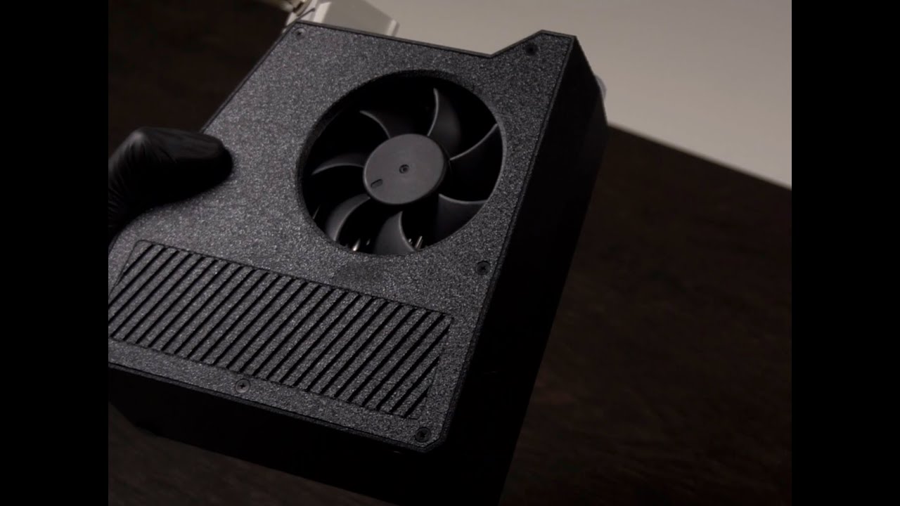

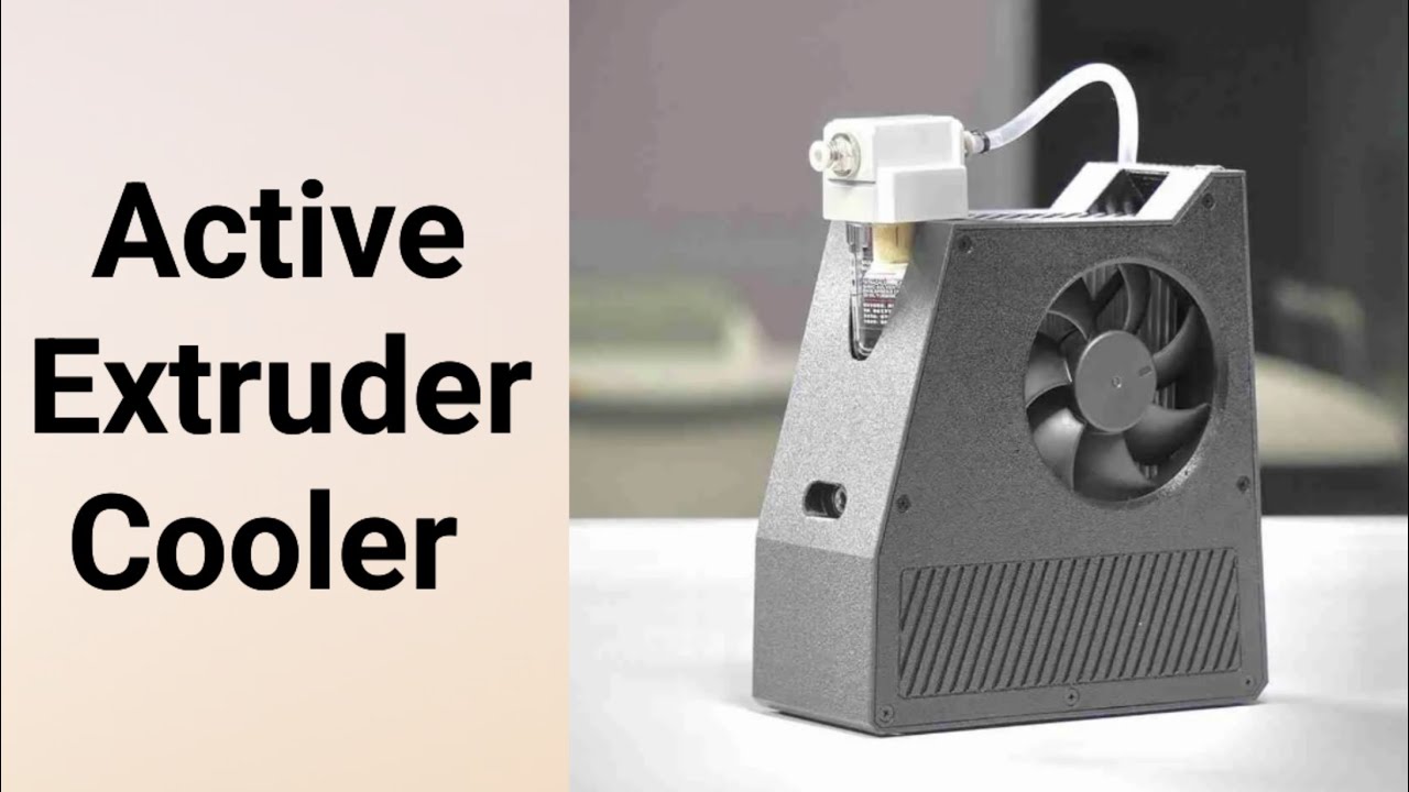

I watched a video on it too, you have to replace the PTFT tube with a slightly larger one. It also has a valve by the AMS that prevents the cool air from going in there. They thought it out but it’s probably not needed.
After thinking about it, the chilled air may be just a gimmick. I bet regular ambient air is cool enough compared to the heat of where it is getting pumped into.
Here is what may be a cheap alternative: Take a regular sealed drybox with filament inside on a ball bearing hub (easy enough to make these or buy one). Hook up as per usual using the usual PTFE tube. Now add a 1/4" bulkhead quick-connect to the drybox and pump air into it with an aquarium pump. That will pressurize the drybox, and unless there are leaks, at least some amount of air should flow to the hotend. See what happens. I’d wager it may be just as good, or nearly as good, and maybe “good enough.” If need be, switch to the larger PTFE tube, as they suggest. to accomodate more air flow.
You can get about 7psi without much trouble on a $20-$40 aquarium air compressor that’s quiet. PM me if you want a recommendation on a good one to buy.

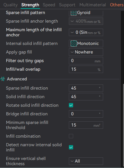

I wonder whether the “Infill combination” slicer setting might help with that:
I could be wrong, but having played with it a little bit, I got the impression that it combined infill layers by printing those infill layers thicker while keeping the prescribed wall layer height. The reason I say that is from observation: it seemed to print at least a couple of wall layers per each infill layer, and that’s the only way I can imagine how it might do that.
[Edit: oops. I missed reading the “shallow angled top surface” part. I was thinking of sparse infil, where you don’t really care about layer thickness as it won’t be seen. So, maybe useful for that, but not for the concern you raised. Oh, well. Maybe there’s some other slicer setting for that. ]

If I understand correctly, you’re saying that the layer height for infill is a multiple of the layer height for walls, but you’re not sure?
This seems like a cool time-saving feature which reduces some of the heartburn from not being able to use two different nozzle sizes.
I was thinking that there might be a layer adhesion issue for the infill from there being more cooling time, but maybe not because it’s compensated for by the fact that the greater amount of material per layer would needs longer to cool.
That’s right. I’ve only observed it casually, but that’s the impression I got. Give it a try and let us know what you think. If I had more time, I’d RTFM. Maybe later. Just passing along the thought before I hit the road for some travelling.

You don’t need an H2D. It’s in regular orca slicer. I showed the clipping where it’s located (under “Strength”). I ran it on my X1C, and I presume it works on the other bambu printers equally well.

I used “Combine Infill” extensively in both large prints (85% Venus de Milo, somewhere between 25 and 30kg of PLA Marble) and the minimum layer height trials. Unfortunately, it is still limited to the to the sparse infill and is not used for solid infill. Nevertheless, it can really help to reduce the total print times.
There’s a big caveat though: With adaptive layer height it works perfectly well in Orca, but not in Studio.
In Orca, we can set a maximum combined infill height. In Studio on the other hand, it can not handle just assing the adaptive layer heights. Instead, it multiplies the default layer height. Which Studio can not do when using different layer heights (yet). So it defaults to a percentage if the nozzle diameter. Unfortunately, the value chosen is far too high (100%). With this, infill tends to get messy with the occasional issue being visible in thin top surfaces.
I do hope that this 100% value is dropped to 60-66% in Studio at some point. Or they just take over the way Orca handles it :sweat_smile:
