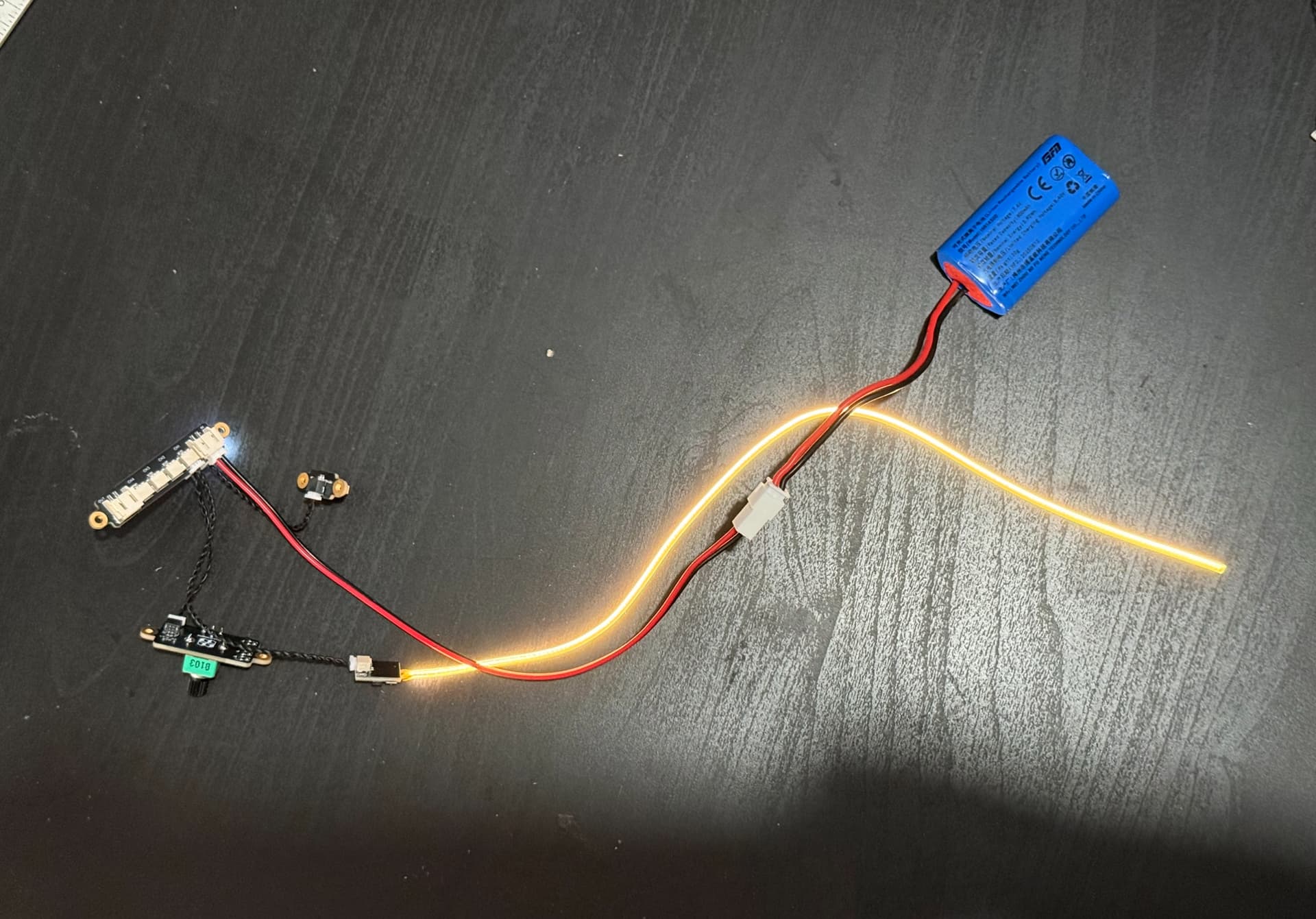

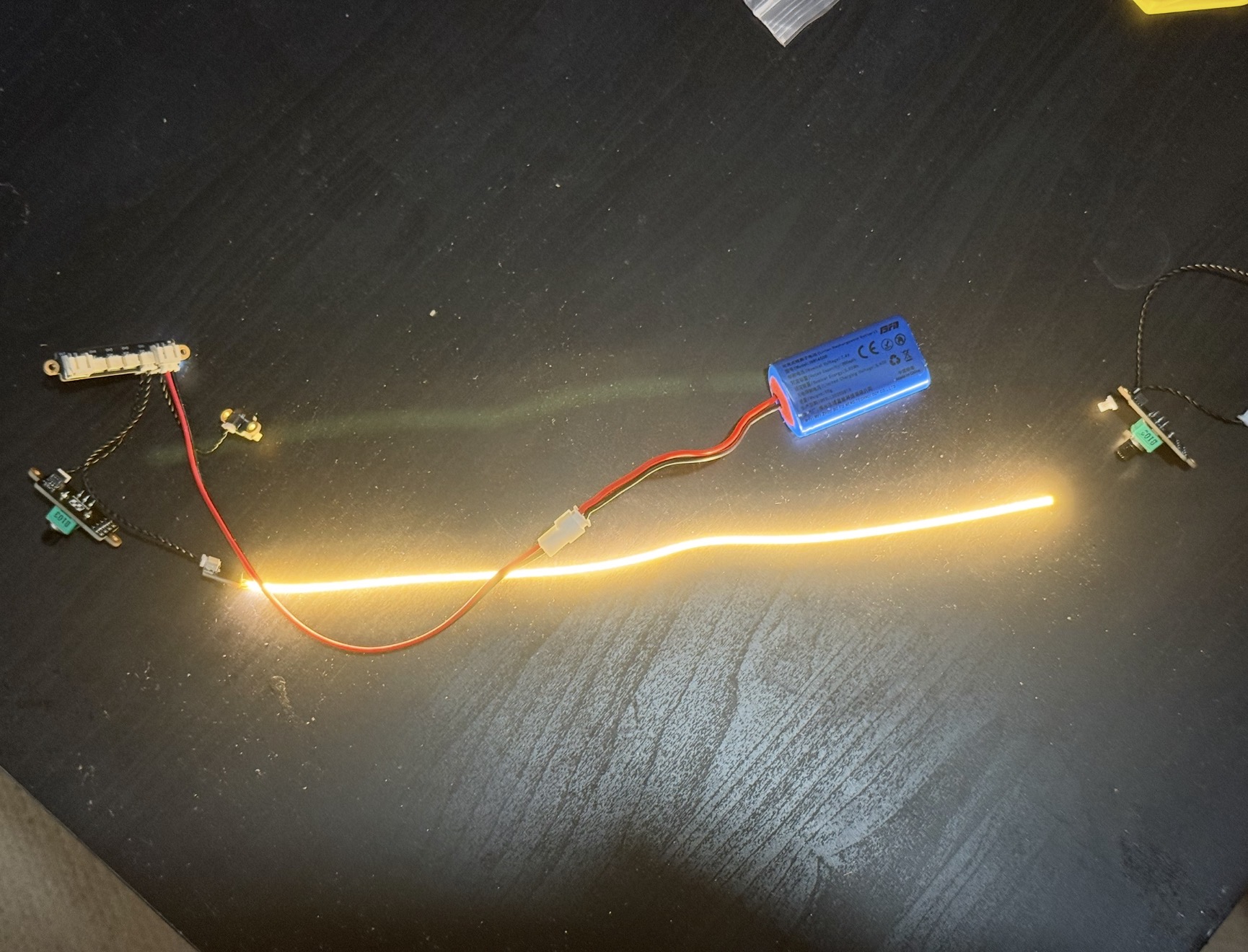

As this need is on my project list, I just cobbled up the various connections.
  1. Li-ion 7.4v battery with XH2.54
  2. Power Distribution board
  3. XH2.54 to PH2.0 cable
  4. COB Light
  5. Potentiometer Board with SH1.0 Connector
It works for me.
Full power via Potentiometer Board.
Half power via Potentiometer Board.

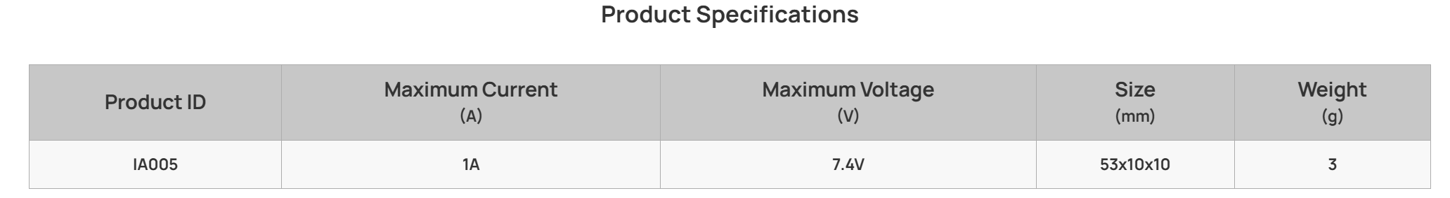

The battery will be connected to the led via this component: Power Distribution Board - 4 Channels (1PCS) - IA005 | Bambu Lab US Store .
Even though it’s rated for a maximum voltage of 7.4V, we can’t expect it to lower the voltage to 5V on the Channels I guess. We would be better with 3 standard AA batteries or maybe another rechargeable battery like the one in that kit:
Rechargeable Power Kit | Bambu Lab US Store ?
Yeah. That PDB is just straight-through wiring. Whatever voltage goes in is the voltage that comes out. It’s maximum voltage rating is meaningless. It’ll easily go to much higher voltages. The Max Current rating is the one that matters. Pull more than that, maybe burn out traces on the board.
